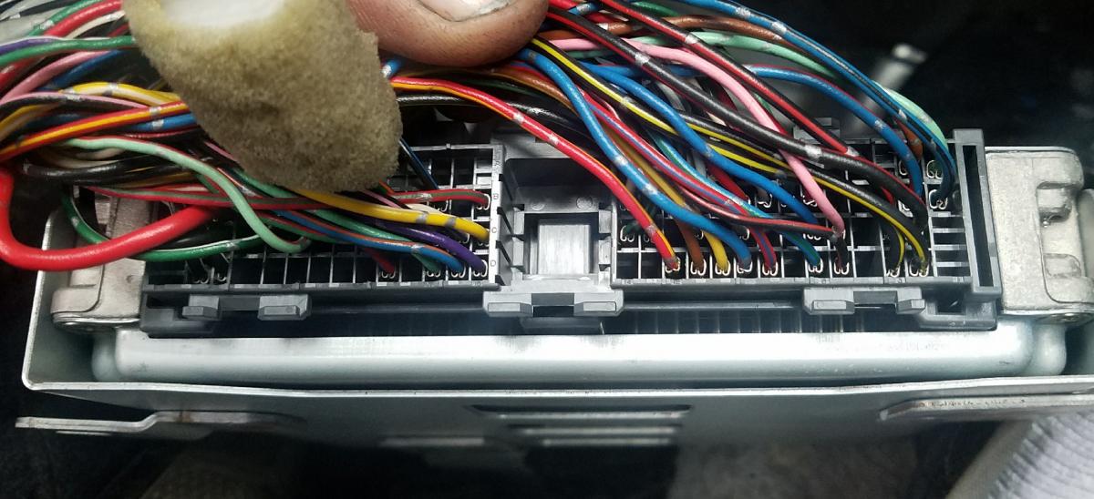

I am getting ground to the bottom right to pins and I'm getting power to the top-left to pins which is technically only half of the injection system I'm still trying to narrow down where the other two injector wires might be because the primary 2 are very thick whereas there are no other thick wires in the ecm harness except for the red power wire...

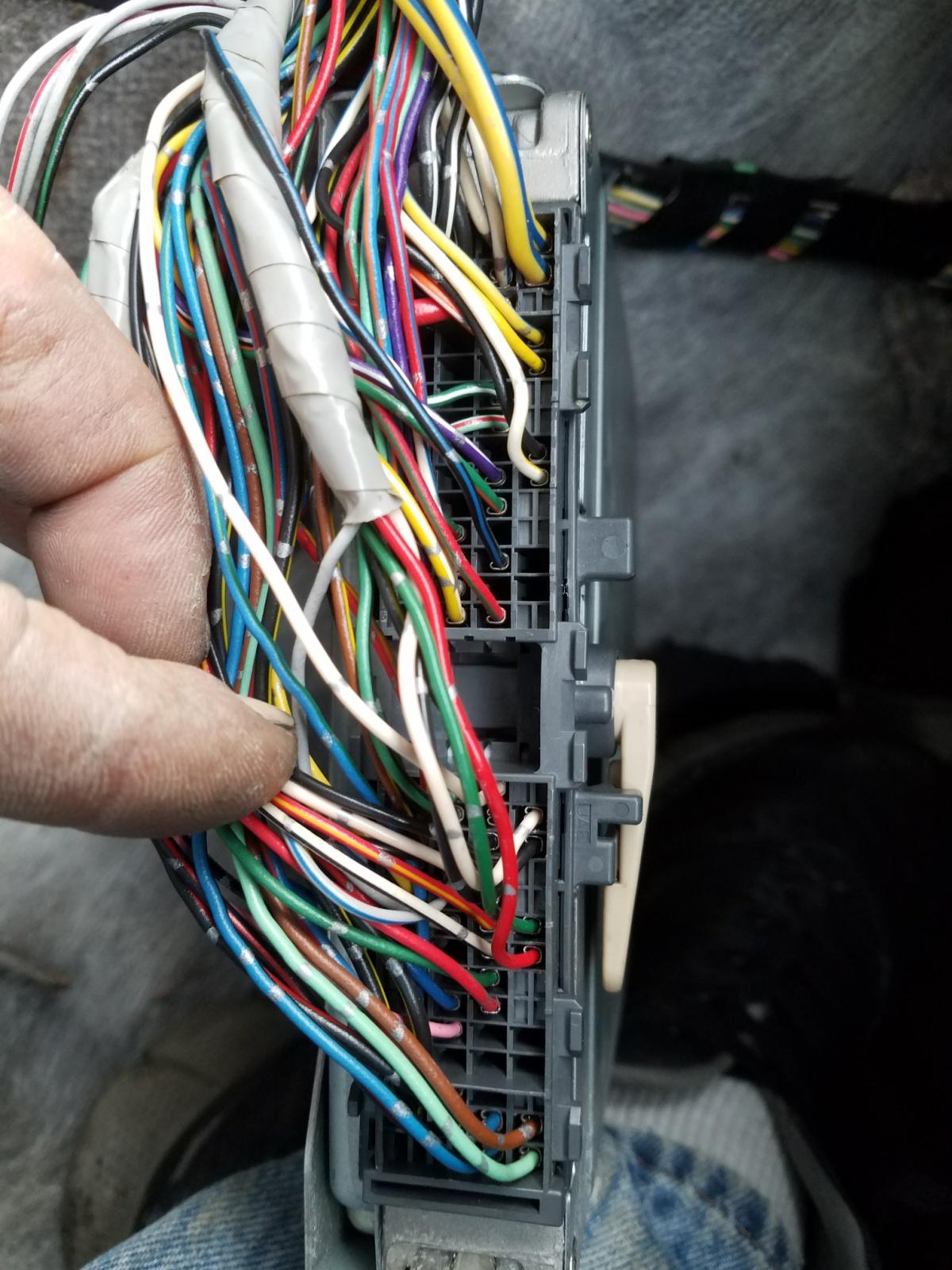

Jesus okay the bottom row far right on my ECM the second to the last two pins are black wires with yellow stripe then there's a blank going left then there's a black wire with a red stripe then to the left of that is a blue wire with silver dots on it then is a blank to the left of that and then to the left of the blank is a red wire with a blue stripe to the left of the red wire with a blue stripe is a blue wire with silver dots to the left of that is yellow wire with silver dots to the left of that is brown wire with silver dots to the left of that is red wire with yellow stripe and then two blanks to the left of that which brings me to the center

Am I PCM my bottom left 71 and 72 are black with a white stripe my far right which would be 9596 or 9495 are black with a yellow stripe. On my harness itself the black with yellow stripe are number two and three and if I go above that the very last top-right wire is light or mint green with a red stripe going around it and the one to the left of it which I guess would be to According to some diagrams and number 15 according to others is brown with silver dots

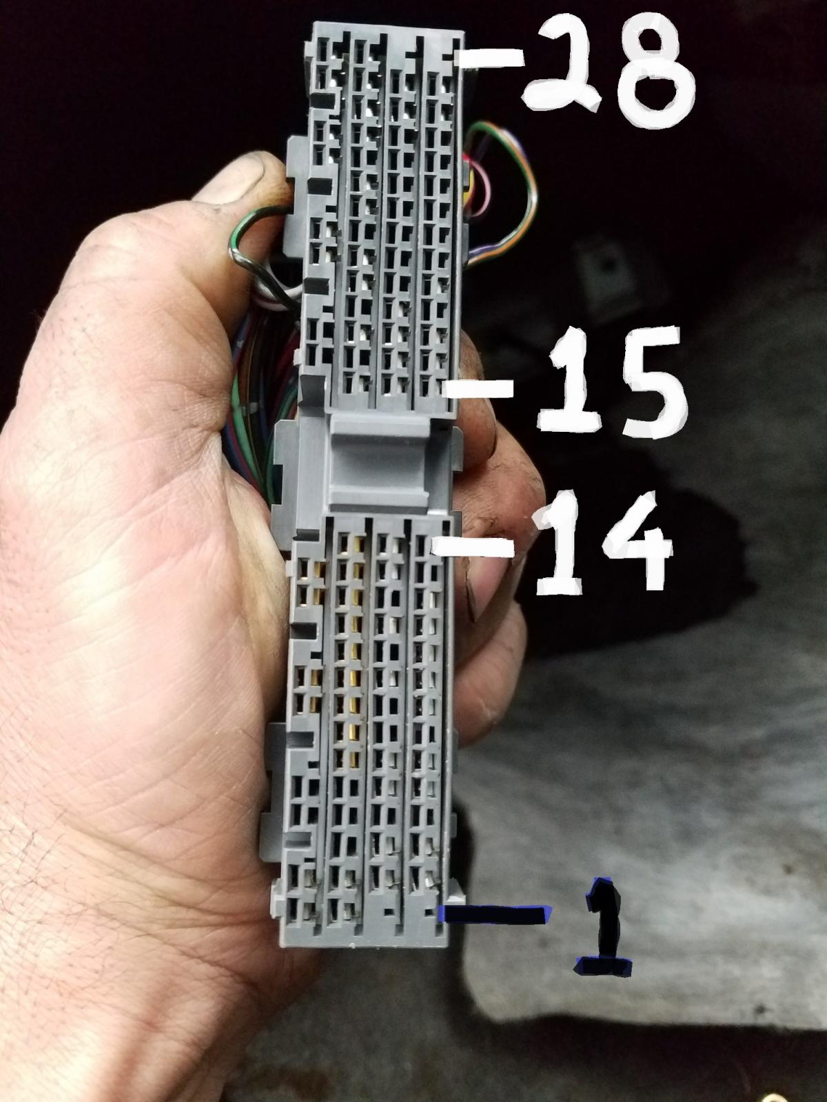

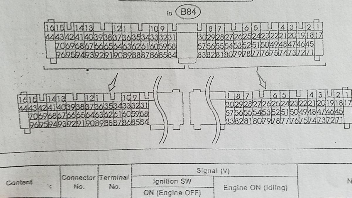

MY #1 pin is at the bottom RIGHT of my ECM, All other schematics show #1 to be TOP LEFT or TOP RIGHT only.... How the hell is this possible? If my attachment will not blow up properly for anyone interested I can email is directly to you and you'll definitely be able to see the numbers from the original photo... Only the harness plug is numbered, the ECM pins are not.

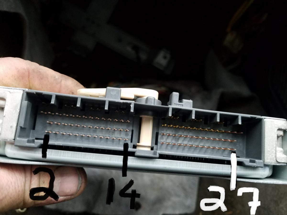

OK.... Looking closely with glasses and a blown up photo, my 95 pins in the plastic clip where it presses into the ECM are numbered from bottom right to bottom left. Bottom right being pin #1 stopping at the center space of the ECM at pin 14, then the center, then pin 15 left of center to pin 28 on the far left bottom. the second row up from bottom right begins with pin 29 and goes up to pin 56... The Lettered row of pins from my bottom first pin numbered 1 is letter D, with C B and A above it respectively.... Am I missing something here....? I restore cars for a living, I do 99.7% of the restorations in house with zero employees but myself, so I have a spoob ton of patience... Yet this subaru, which should be a 10 minute fix, is pushing all my patience buttons to get it on the road again, and I am undoubtedly getting far too deep into something simple, which I hope ALL YOU folks kick my rump roast for later as you laugh at my follies 8) 8). I simply need to understand this pinning in this ECM first since I've gone this deep, I may as well understand it. See my photo, look closely, my numbers physically do not match ANY of the diagram photos offered thus far
