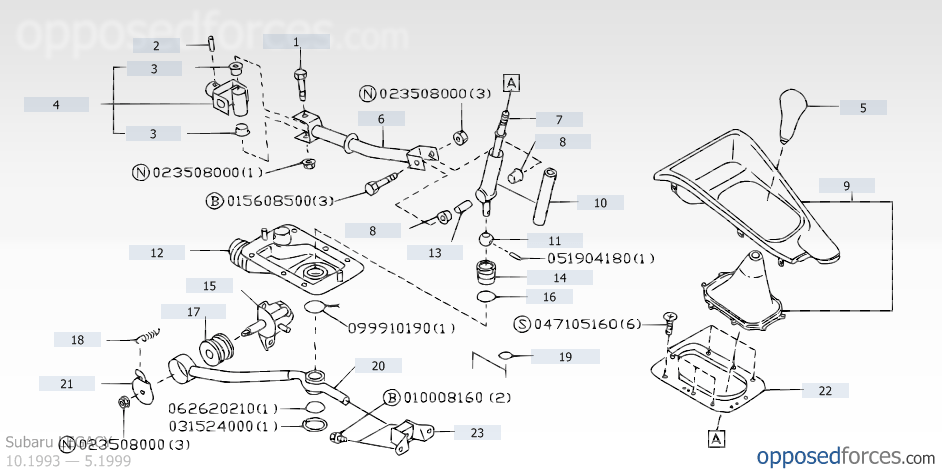

  7. I figured it out, I was missing the bracket so I made one works great and shifter isn't so floppy. It's item 21 this isn't my exact shifter but I looked through a few of these and it seemed they are fairly common.
  8. I can't express the amount of gratitude I have to all of you for taking the time to help me get this done. First test drive was tonight, no issues noticed. Couldn't have done it without all of your help. Reverse and 4x4 light ate wired up and I'm just waiting on the console and a few small things to be finished. I had to customize the trans mounts for some reason but other than that it was a pretty smooth experience. BTW Where does the spring on the shift linkage go?
