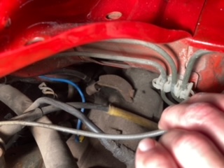

  1. I'm working on my 1983 DL Wagon (5 speed manual trans, front wheel drive, 1800 engine). I bought it as a non-running basket case to challenge myself, fulfill the desire held since watching the 1980 Winter Olympics back in fifth grade, and go even balder by constantly scratching my head! So, as the first picture shows, the clutch cable just floats over the trans and there is a clip attached to the trans that I believe is positioned improperly. I would think the cable should go through the clip, but if it did, it would be heading down, away from the fork, not towards it. I've looked through the 800+ page manual for guidance, but found nothing that provides any clarity. Because the car had so many idiosyncrasies (like lamp wire attached to wiring in the fuse box for a siren), I've gotten a new clutch cable and want to install it correctly. I'm fine with the front and rear attachments to the fork and pedal, but really want to get it right in the middle without the guesswork of relocating the clip. Any guidance or pictures of the correct positioning of this clip would be greatly appreciated. ALSO, there is obviously an unoriginal wire (blue wire attached to front right bolt of trans top) that goes to the firewall. Is this correct? Do you have a wire there that goes to a different spot? Any help on this would also be GREATLY APPRECIATED! Thank you! Starting point to current pictures are included for your pleasure! I will get to the end-point (someday!!).

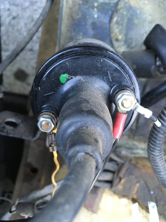

  6. Thanks all for your guidance and I really appreciate learning about this. I bought the 800 page service manual on ebay last year, but I feel like a need a reading specialist to navigate it most of the time. That being said, yes this wire in question is a noise condensor for the radio signal. With the guidance of the specialists, I figured out what to look for in the manual!!!
  7. For what it’s worth, I replaced the entire exhaust on my 2000 Legacy Outback (long story). Everything was great for about a year and then the P0420 code popped up. It took me a while to figure out that one main difference between the old and new exhaust was the insulation before the cat, so I wrapped the exhaust tightly up to the front cat and the code has stayed away for over 1,500 mile so far.
