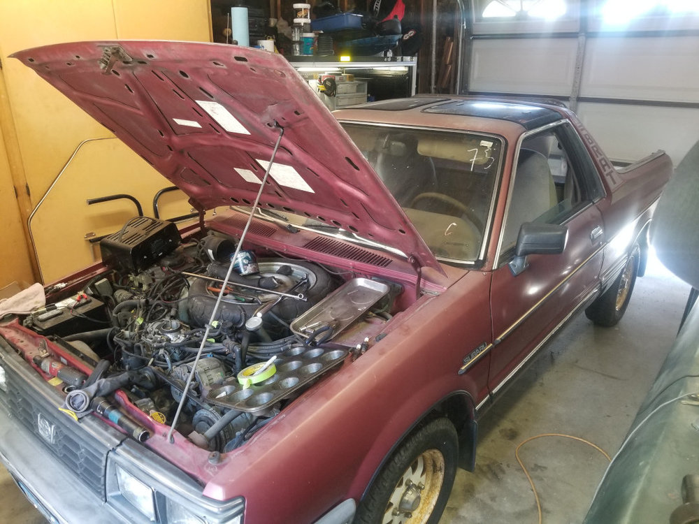

  1. It's where I keep all my most valuable parts, specially my muffin tops. Ancient mechanic technology, use the old lady's baking hardware to keep your nuts and bolts.

  3. Thus begins the saga of rebuilding a seized engine, a seized water pump, broken bolts, registration woes, and the many other problems from sitting for years in who-knows-where. So far, it's living up to its namesake, but it's complete and in good condition.
