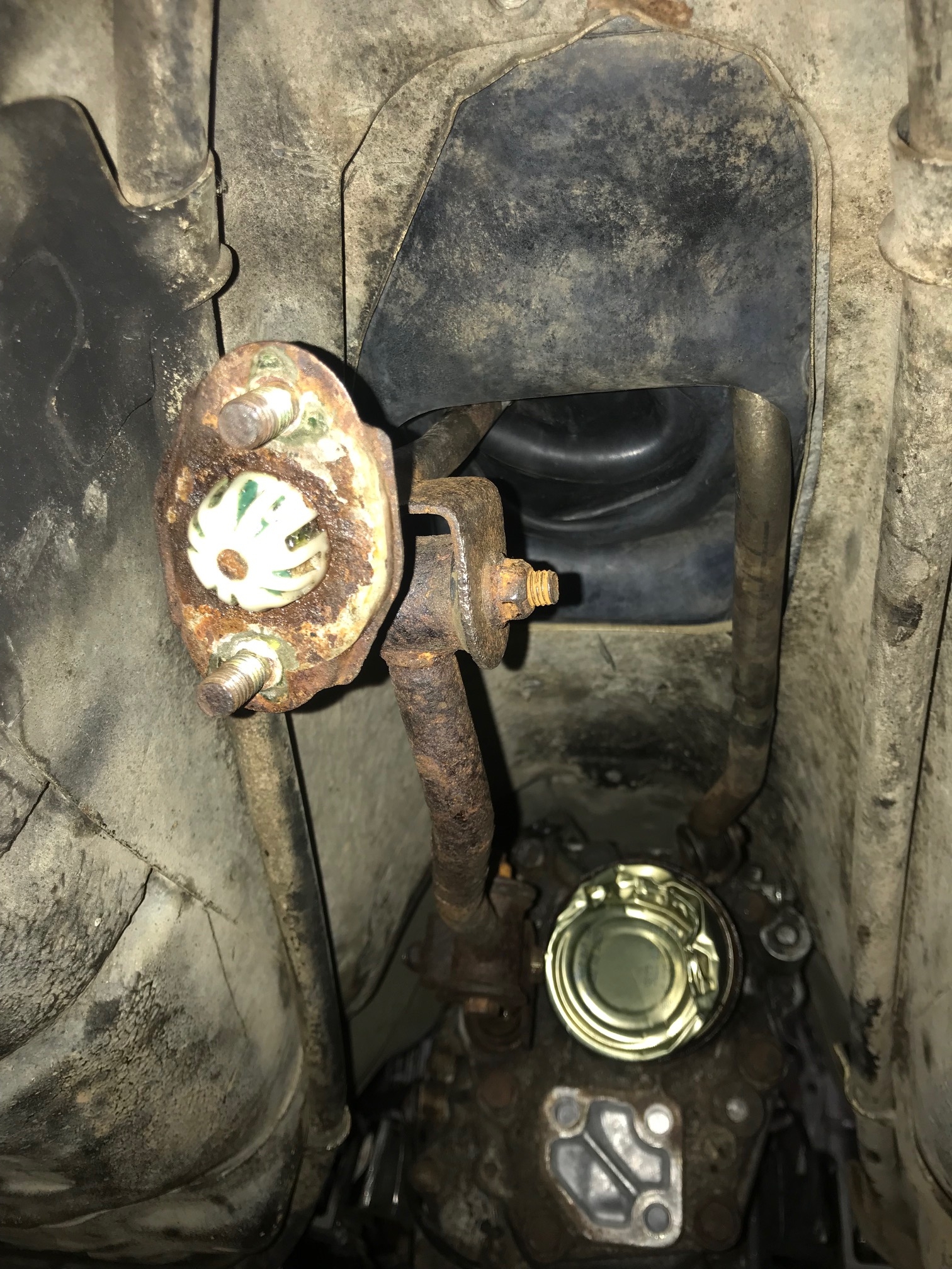

For those who have Jerry's 4 to 5 Speed conversion kit... How have you mounted the gear shifter?
I now have the 5 Speed D/R transmission in place with Jerry's conversion kit on my '82 Brat. Only problem I've found is that I cannot find a place to mount the gear shifter. I've had no problem with the 4x4 linkage because its held secured between the transmission and the high/low shifter in the interior. On the stock 5-Speed, the shifter is mounted on a bracket that also mounts the 4x4 shifter, however I cannot fit that as it will interfere with the driveshaft. I've talked to Jerry himself about what he recommends, but he mentioned mounting it via studs located along the transmission tunnel that I could not find. I don't want to burden him with anymore phone calls from me. I've thought of drilling some holes into the side of the transmission tunnel to create some kind of custom bracket, but I figured that I would post a picture and ask here before I go doing any of that.
