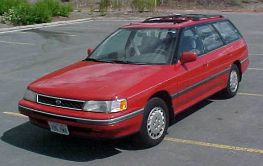

Well, I think I’m committing the unpardonable sin. I’m selling my ’90 legacy wagon and buying a minivan. We now have four kids under the age of 6 and we can’t all fit in the legacy anymore. My wife’s been driving them all around in our suburban, but with gas prices the way they are it’s killing us. So we’ve made the decision to sell the sube and get a Honda Odyssey. That way she can have the convenience of the van, better fuel economy, but I’ll have to take the suburban to work. I only work 3 miles from home and I usually commute by motorcycle anyway, so it won’t make too much difference to me. But I’ll miss my sube and I don’t look forward to having to drive the pig. But we need it to pull trailers and get to our cabin in the winter, so I’m stuck with it for a while. So – just wanted to thank everybody on this site for all the help. This is definitely the best auto forum I’ve ever seen and it’s helped me out immensely. I’ve been looking for a similar website for Honda Odysseys, but haven’t seen anything even comparable yet. Any suggestions? And does anybody have any comments or things look out for on a ‘00 Odyssey? And my legacy is now officially for sale, so anybody who might be interested is welcome to contact me. It’s a ’90 legacy wagon LS, all the options except the air shocks (which I replaced with struts) and everything works perfectly. The car is in excellent condition with no rust, dents, and only the usual dings & chips you’d expect for 185k miles. It does have an auto tranny which still works great. I was thinking of eventually swapping it to a manual. Perfect car to do it on because of the great condition of the rest of the car. Thanks again – hopefully I’ll be back in a subaru someday. Dave dashton@wencor.com
