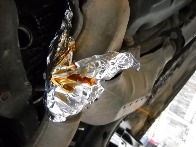

okay, imagine my surprise :eek: when I popped off the drain plug on the front differential and a gushing torrent of fcuking ATF came spewing out. guess all I can do is fill with gear oil and refresh in a week or so. Wow, definitely going back to the dealer to look up all the work that was done. I hope the front diff isn't borked-no metal came out-good news I guess. the aluminum foil I wrapped around the header hardly got touched but the ground sure did :lol:
bottom line-you buy a new scooby. check or have everything checked.
if they put ATF in the diff, what did they put in the trans?????? :eek: hopefully something fluid.
10 qts of 80-90? that would take like an hour to add :-\. Nope, the tranny fluid is the same color as the front diff (was):mad:

Make sure the trans isn't loosing ATF - there's a slight possibility in 4EAT's for ATF to be pushed into the diff I think, I've heard of it before I believe. In that case it wasn't added, but there's a bad seal in the trans.
If it really was added wrong then there's no telling what, if any damage, occurred. ATF is a lubricant, not meant for differentials and horribly out of spec but at least it is an actual lubricant. I wouldn't be surprised either way. Good news is differentials almost always give you ample warning signs, like noise.
it was all ATF, absolutely no gear oil- a pretty dark garnet red :) I can't believe when the "subaru tech" checked levels of all fluids the red fluid on the dip stick didn't raise a red flag.
at least I know my shaft seals are good if they were holding in ATF.
