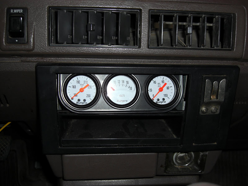

Could you post up pics and more info on your gauges and setup? I'm thinking of doing the same on my 88 DL, but surprisingly there isn't a lot of detail. Most everyone seems to recommend it, but not many write-ups on their install.
Post pics of your GL as well - love to see what 29's would look like on one! (crap my landcruiser has 33's which is a nice step up from stock - though i aspire to 35's!):rolleyes:
GL!
rob
Cool, I will post pics today or tomorrow.
As far as the guages go, I bought one of those $25 3 in 1 kits at autozone and went online to the manufacturer website and purchased a metric conversion kit for about $5+shipping. It's essentially a bolt in setup, except the electrical portion, which I bought some little splice dealies and spliced into the cigarett lighter for voltage and the cig lighter dash light for ilumination of the gauges and dimming control.
The way I have the light for the gauges setup is kind of neat. Since it's a negative ground system and the dimmer is at full resistance when the dash lights are brightest it dims with the dash lights when vehicle lights are on. When they're off the gauges are at full brightness.
next to the oil sender on the oil pump there is a plug you can remove and install the 1/8 pipe thread fitting with the compression flair on the other end. This way you can keep your dash sender as well.
Search around some more I found all but the metric conversion trick on here.
I'll be back with the pics.

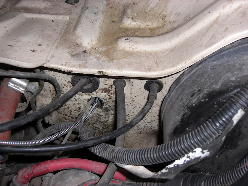

Here's a hole in my firewall, oil sender and the Sunpro cheapo gauge cluster:
In the other photos in the link you can see the metric to sae adapter in the intake manifold.
Thanks man! That's what i was thinking of doing - at least those 3 (oil pressure, volts, temp (coolant or oil?))
The only other thing i wanted to do was get a tach to see where my RPMs are at.
Appreciate the pics - did you go electric or mechanical?
rob
Mechanical oil pressure, voltage is self explanatory, and capillary style water temp.
Careful not to accidentally kink or crimp the capillary tube. And keep the plastic oil sender tube away from the exhaust or anything moving. I think they make a copper replacement you can buy to replace the plastic.

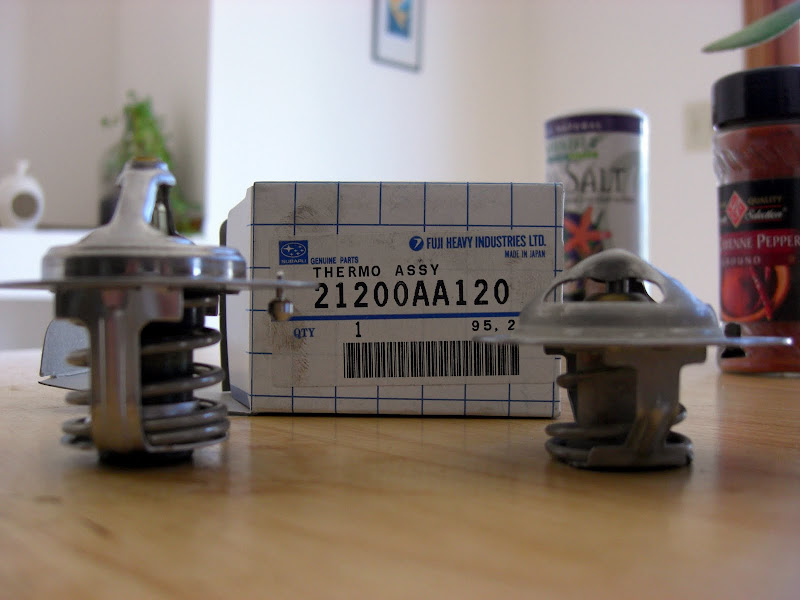

I picked up the throwout bearing spring clips, thermostat, oil relief springs and oil filter from the dealer. There is a noticeable difference in the spring rates of both cam carrier springs and the oil pump spring. The oil pump spring is about one millimeter longer than the old one, as well. Here is a picture with the part numbers (I think they cost me about $1.30 a pop):
I wonder which one is OEM?

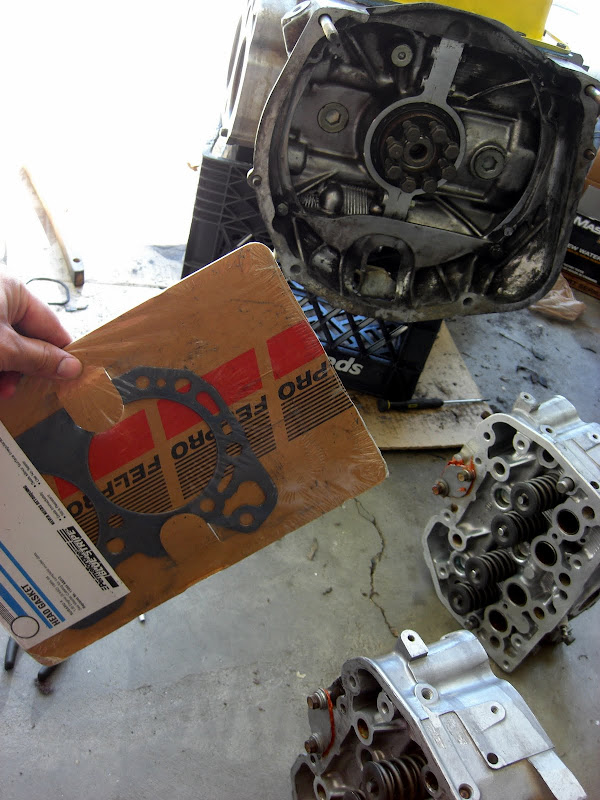

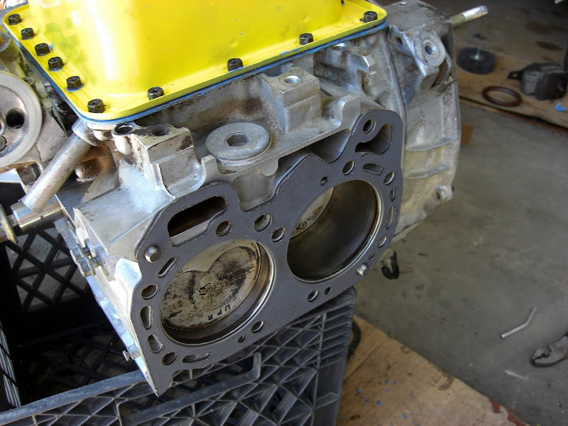

I got the heads back, lapped the valves and threw on the permatorques with final torque of 55 lb-ft. Here are some pics. Do you guys think I should retorque after run-in or just call it good, as is? I'd rather not pull the engine again.
Merkatroid and I replaced the head gaskets on an EA-82 TBI and we only torqued them once, however we brought the torque a tiny bit higher than spec. and the car has been running amazing since. Its merkatroids $200 Loyale, that wont die. The thing has been overheated to amazing levels before we fixed it, and it just keeps on chuggin. So, I think you will be fine without retorquing them.
Thanks for the reassurance. The book says 47, so I took it to 55 lb-ft. No work on it today. Instead, we brewed 12 gallons of Belgian double.
