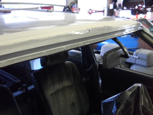

I am finally trying to fix this. As near as I can tell this is where the water on the passenger side floorboard was getting in.

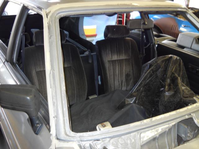

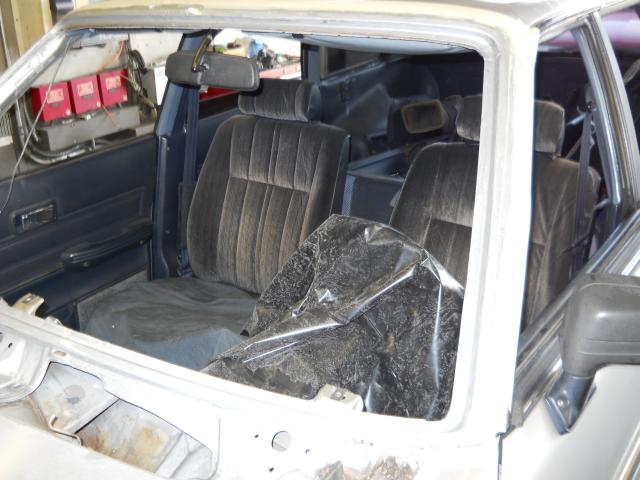

This is what it looks like with the windshield out (I managed to get it out without breaking it:D)

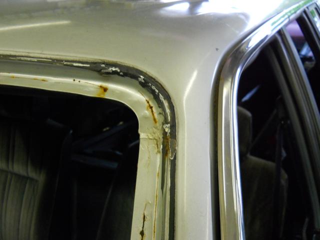

Here is the drivers side. Not nearly as bad as I thought it would be. At least there is still some metal there.
Edited by Crazyeights

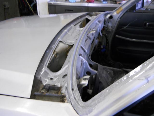

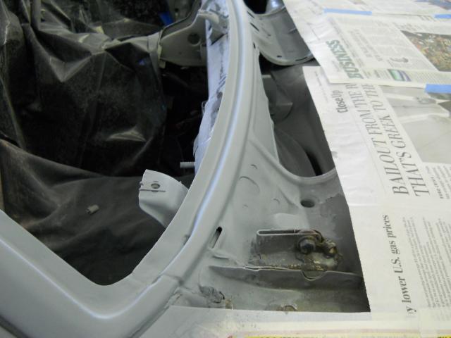

These (drain holes?) were completely plugged up with old sealer and debris.
You can see where the person that removed it last time cut the paint with a blade. It looks like this is what started some of the rust.

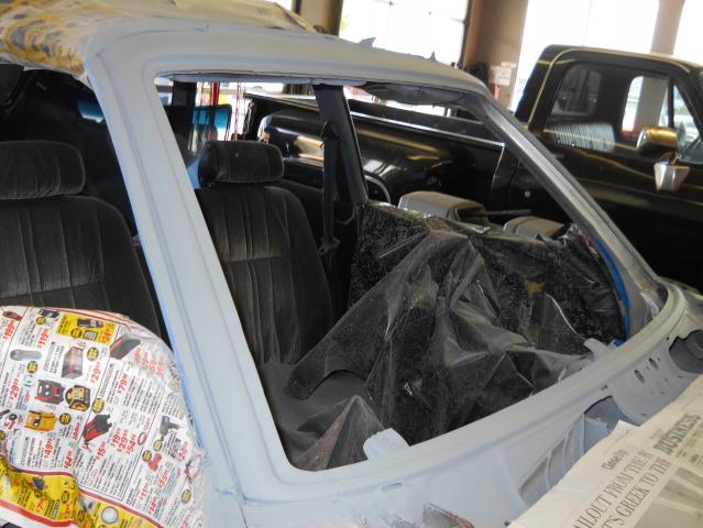

Here it is after some cleaning up.

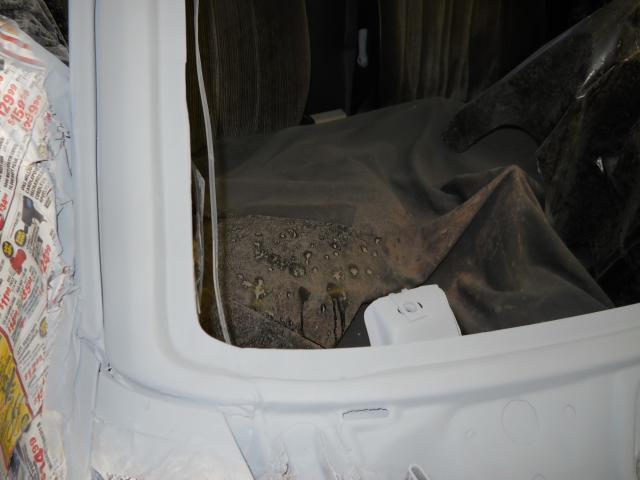

Now, after POR 15 Marine Clean, Metal Ready Prep, and POR 15 Silver.
and the other side
A few more shots showing the rest of the window channel. Hopefully this will do for a while.
A couple last thoughts. I should go over the POR 15 with something. The directions say it is not UV safe. I also have to try and figure out how to blend this mess in with the rest of the paint so it doesn't look too bad. Painting the whole car was not part of the plan right now:D
Thoughts, or criticisms?

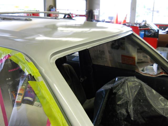

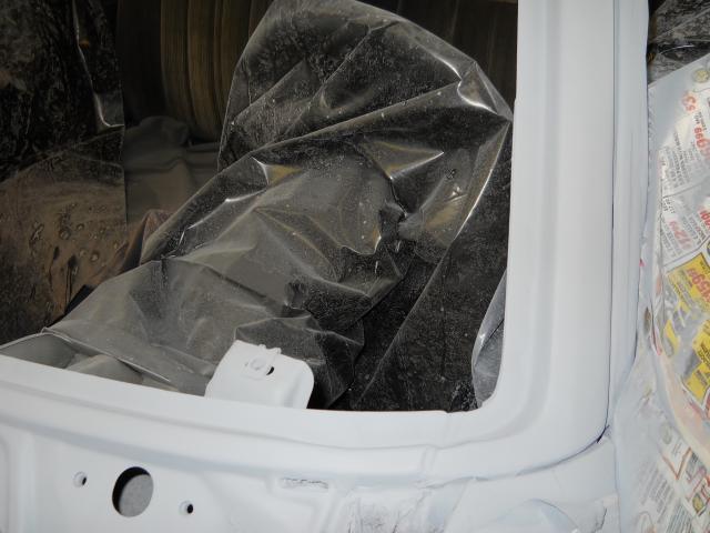

Here is the latest update. Obviously I am not a body guy, but it shouldn't rust and it will look a lot better than it did. I'm thinking I want a glass person to put the windshield back in though. Now I need to find some 392 Lightning Silver.
I read somewhere that the rope in style windshields seal better using butyl tape between the gasket and the body. Any thoughts on this? Also, does urethane sealer or anything go in between the glass and the rubber gasket?

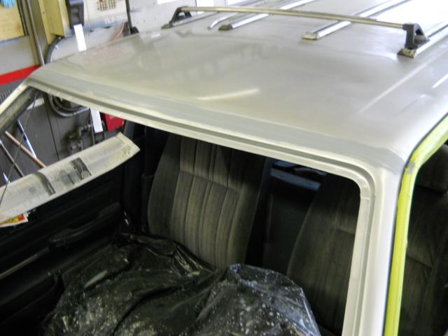

It's coming along slowly. I learned the hard way NEVER use cheap 5 year old masking tape:D It's well worth the few extra dollars for the good stuff. Here are some shots of progress from the last few mornings work. I haven't done this before so I am learning as I go. Although it's just rattle cans, it's still pretty rewarding to see it start to look nice. Blending the new paint in with the old sure took some trial and error.
What a HUGE mess this makes, protection for your lungs should be a must too.

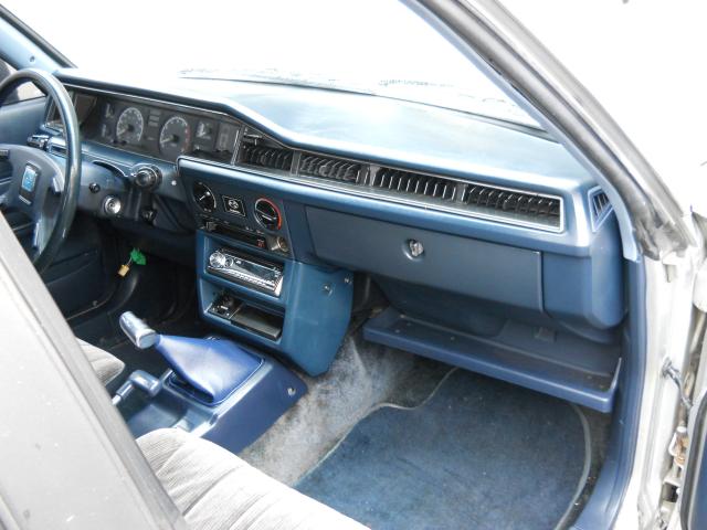

After a week of rain on and off it's dry inside for the first time in years! It looks like I can finally put half decent carpet inside it now:clap:

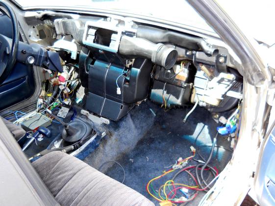

I'm starting to put the dash back together. I replaced the foam strips inside under the windshield and most of the worn out foam in and around the HVAC units. I also replaced the heater core and the heater control valve. I added a factory AC evap unit so I can hook up AC at a later date.
I'm also going to take the time to sort out and clean up some of the wiring related to the EJ22 swap and the center diff lock (on the floor - right side) while the dash is still out. I am seriously considering moving the engine controller to the passenger side.
