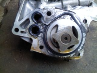

July 10, 201114 yr OK guys. I don't know if anyone will still be reading these posts, but i dove in today and decided to pull off the oil pan and oil pump. It was quite fun trying to pull the oil pan off . The back 3 bolts were terribly fun... that is where the pan was leaking from... BAD:banghead: It took me awhile to figure out how to get to them. I noticed some holes on the cross member.. I remember from someones post how to get to them. I ended up using a 10mm 1/4" socket and a screwdriver.... ughhh... lol put the socket on the other side of the hole and contort your hands and body in just the right position.. lol, don't worry it ony takes about 4 freaking hours.... But I was wondering if i should use gasket sealer on the gasket when I put it back on ? Any suggestions? As for the oil pump... oh yeah more fun... This time I tore off the timing covers and threw them out. Good thing i took off the oil pump once already.. so i knew where the bolt holes were... man.. alot of work.. I took some pics of the oil pump after pulling it off...here ya go : The oil pump "Mickey Mouse Seal " was torn... I didn't find any surprises in the oil pan except a few flakes of GOLD! lol... Just a question about the oil pan... Should I put some RTV on it before puting it back on ? I am thinking just on the bottom side? The old one was stuck like glue on the bottom side.. The top side wasn't stuck at all... This is all going to be back together tomorrow.. then I will be ready to roll :-\
July 11, 201114 yr I'd use the non-hardening form-a-gasket on the oil pan. Manual gauge in my 86' shows between 5-10psi when hot. I just figure the TOD is a timer, time to change the oil. Ed
