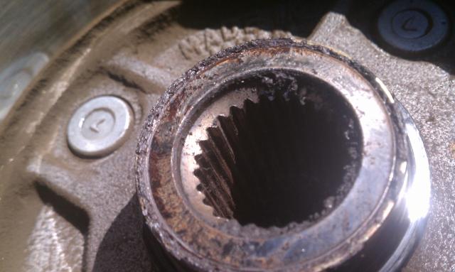

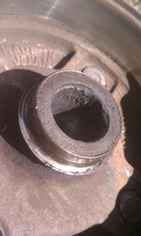

September 23, 201213 yr Author so i finely got a chance to play with my wagon today and found the problem some how the brake drum dident have any splines in it it was just smooth in side i pulled a different one off of one of the others laying around i have pics of the inside of the drums but cant figure out how to upload there im feeling kinda stupid because ive been in there before chasing a squeak and bind pop sound funny that sound isent there anymore ether afew more adjustments and im ready for the trail
