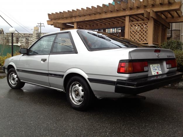

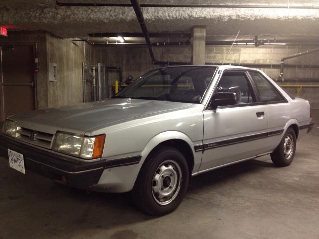

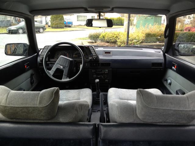

October 16, 201213 yr this is my GL Coupe, It's in great shape very clean and same owner for 25 years. It has minor rust and some small dents and scrapes. It was a city car hardly ever driven, running poorly, terrible lifter tick, full of carbon. after some treatment in the fuel and oil then a hard drive on the highway the carbon is burned out now. Interior still smells like smoke even after steam cleaning, needs ozone treatment. all that I have done so far; -oil and filter change -fuel and oil conditioner flush -itallian tune up (drive at 4500 rpm for 30 minutes) -full steam detail inside -degrease engine compartment -removed loose rust -removed ugly blue pinstripes with auto body eraser -pressure washed underside and wheels to remove grime and grit -repaired and replaced small interior broken or missing trim parts still needs; -new axle -main pulley and belts (pulley broken, only one belt channel -steering dust boots look damaged -rust repair and body work -more steam cleaning -ozone treatment for smoke Wish list; -sweet sexy wheels -RX body kit -LSD of course -webber -new speakers and aux audio in mod to factory radio -convert to AWD (FWD 5spd now)

November 5, 201213 yr Author I tried the aux audio input into the 5 pin on the back of the deck today, but got frustrated by the previous stereo hack job. So the radio and speakers have always been messed up since I got this thing, but more important mechanical stuff has been priority. The previous owner had a equalizer amplifier hacked into the wiring harness, and of course all fouled up with the common ground. It was wired really good, hard to take apart, just all wrong. Even had a plastic sub with only one channel hooked up. So I ripped it all out, cut out the crap in the harness and rewired and shrink tubed the whole deal. Nice and clean and back to subaru. Only one out of 4 speakers not working, better than before. never got the audio aux to sound any good though, too much noise. How about the crackle when turning knobs, I tried to clean out the contacts inside, but too hard to get to, I just ended up spilling acetone all over the freshly cleaned knobs and melted them a bit. Fixin old stuff never goes easy or as planned.
November 6, 201213 yr Author Could the radio and tape deck left speaker channel is fried from the previous owner running a dead speaker for years? I swapped my deck from my wagon in, and no problem, my wiring harness fix is solid, and the tape deck still has bad left channel with this deck. But this radio regularly squeals going in and out of stereo, any fix for this?

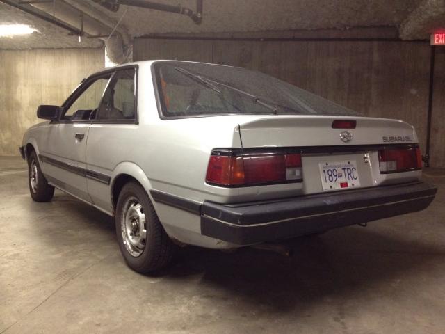

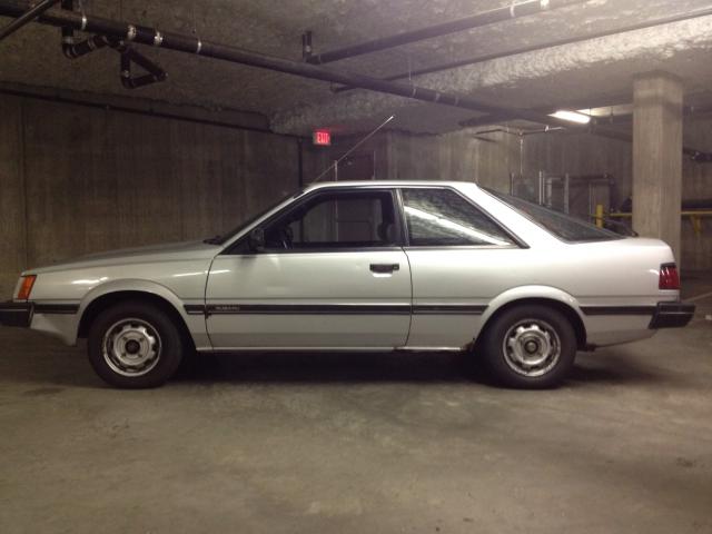

February 5, 201313 yr Author Some new Pics, I have recently; steam cleaned again and will need more for the yellow smoke stains, rotor, cap, wires, plugs, timing belts, and have a new axle to put in. have a new harmonic balancer, but it has no hole, key hole so I'll have to drill one, and put the timing belt covers back on. then new muffler and air care, a bit of shine here and there and ready for the collector plates application.

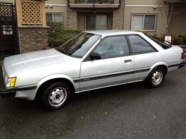

July 14, 201312 yr Author Still doing more restoration work, getting ready for the langley car show, and applying for collector plates.
