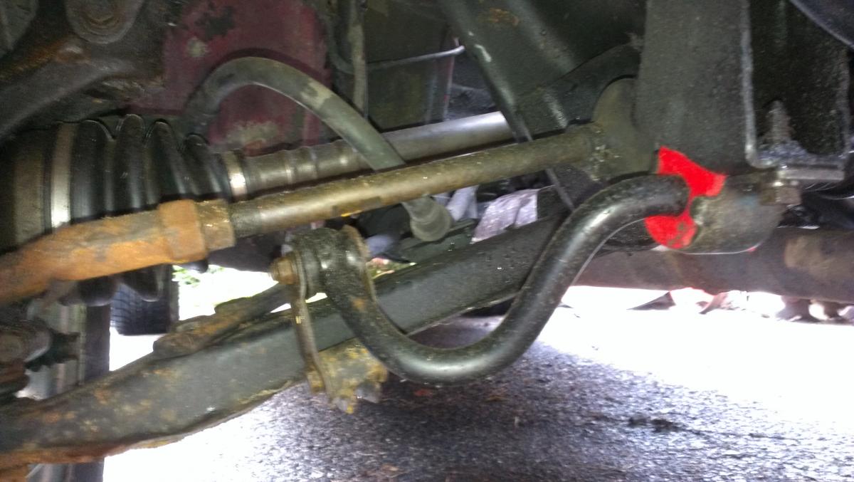

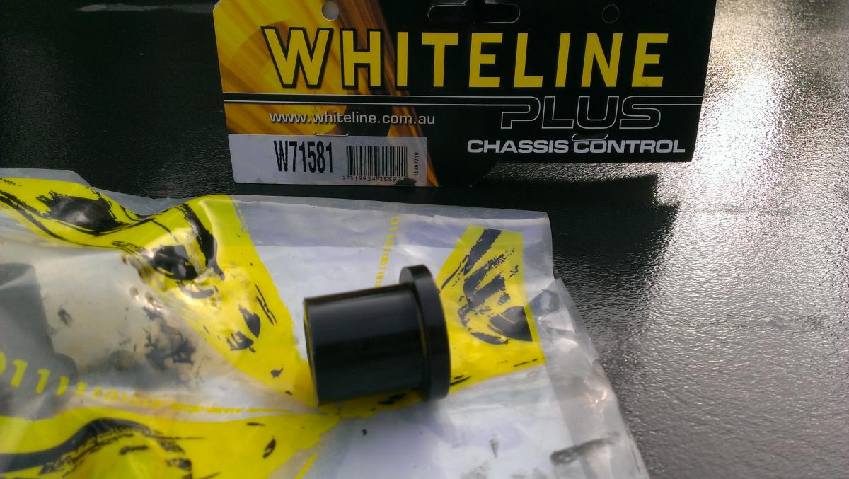

I had similar issues trying to locate a usable bushing for my EA82.  using a caliper I measured the existing bushing and sleeve trying to size up a replacement.  Eventually after a few failed attempts i wound up using Leaf-spring bushings.  Cost me $35 delivered (not including cash spent on the ones that didn't fit) for Whiteline #W71581 Rear Leaf Spring Bushings - Rear Eyepost-26549-0-33468100-1374583389_thumb.jpg
They are a bit of a chore to install.post-26549-0-91248900-1374583717_thumb.jpg but worked out better than the ones I tried to trim-to-fit.
