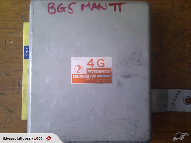

this is what im looking at on a Website here in New Zealand... Do you know if this is for a 1998 Subaru Legacy GTB...
this is what it says on the auction....
SUBARU LEGACY GTB TWIN TURBO MANUAL 4G ECU
BG5 BD5 GTB 3 PLUG.
22611 AC562 A18-000 DR5....
I questioned them if it was the correct one and they said yes but i jus want another opinion as for its not the same as the ECU that i remember seeing in the car...post-50000-0-20579200-1382419534_thumb.jpg

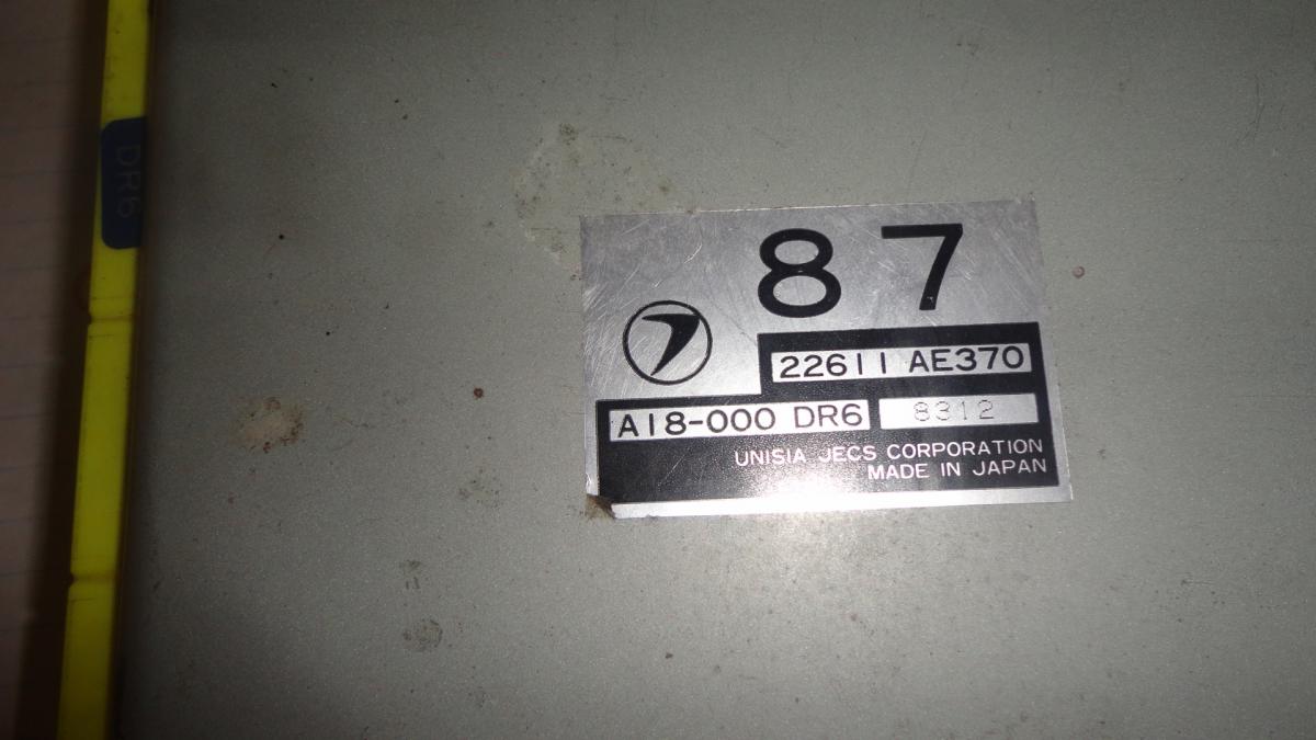

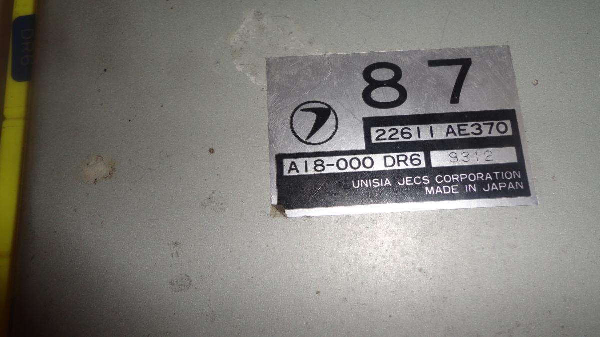

I FOUND THE ECU FROM MY CAR AND ILL ATTACH THE PHOTO... DO YOU KNOW IF ITS THE RIGHT ECU OR NOT LOL...
Edited by kenathena
we don't get those turbo engines here, completely different in the US so you'll need some NZ informed folks for true interchangeability options.
