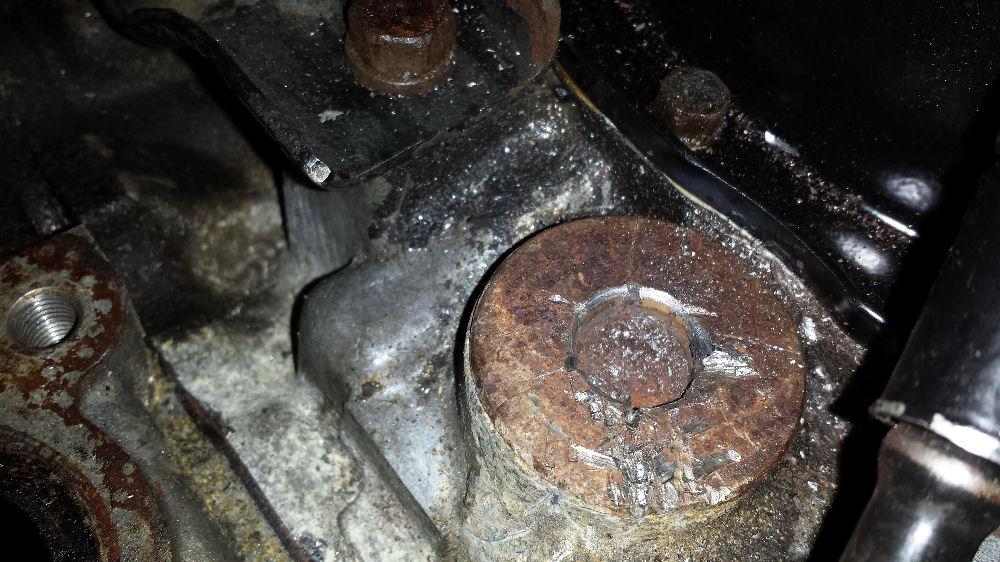

January 16, 201412 yr The one for the engine block heater.. I've tried heat and I tried using a 3lb hammer and hitting the plug sideways and it still wont move at all.. Did the plug win? Any other tips I should use before I give up?

January 16, 201412 yr Coolant + steel + aluminum = major stuck. Soak it in PB, clean the crud out of the center, use a half inch drive socket and breaker bar. Put pressure on the bar and then smack the bar with the 3lb hammer about 6" from the socket. Do that a few times and make sure the socket doesn't slip out and round out the plug.
January 16, 201412 yr If its already rounded out you could try a big pipe wrench or vice grips. You may have to just leave it.
January 16, 201412 yr Author Only other way I can think of is to file down notches to my next size hex socket and try again..
January 17, 201412 yr Chisel,air or otherwise would be much easier. Make an indentation by holding it at 90 degrees . Once there is something to grip,angle the chisel 45 degrees or so to spin the plug. Hitting as close to the OD as you dare will give the greatest turning torque. Blows will help penetrating oil penetrate
January 17, 201412 yr Author See all those marks? Well those were from a flat head screw driver but still it's hard to hit from the OD without ending up hitting too deep.. I will spray with a little more kroil and then if that does not work then I will just have to file the plug to the next size and use the impact wrench on it again
January 17, 201412 yr The one for the engine block heater.. I've tried heat and I tried using a 3lb hammer and hitting the plug sideways and it still wont move at all.. Did the plug win? Any other tips I should use before I give up? hi, i can see from that picture you have no chance to get that out by conventional means,, i DO think you can weld a BIG nut on it something like a axle nut for instance,, no jb weld ,,actually electric arc weld and weld it good ,, a nut too big to strip and use a 6 point socket & big breaker bar on that. the heat from the weld job will likely help too.

January 17, 201412 yr Oh, I completely misunderstood which part you were working on. Do you already have the heads on the motor? If not you can easily spray pb on the threads on the inside of the motor.
January 17, 201412 yr Author I haven't taken the heads off, I did not notice that it could be sprayed from the inside of the block.
January 17, 201412 yr Yeah, you can get to it through the lower coolant passage of below the cylinders.

January 17, 201412 yr Author Picked up a hard cap chisel in 1/2" at least I will have a wider serface area to bite into and for the striking end as well.. too many missed blows
