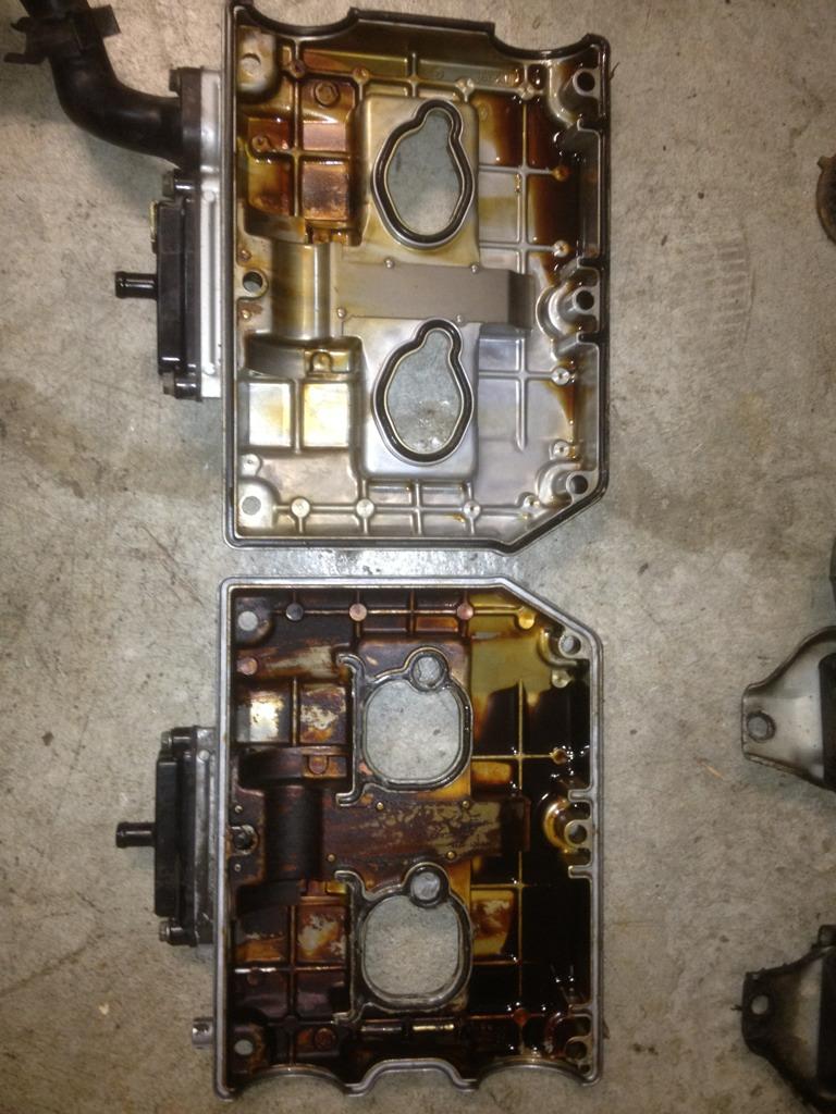

Oh, and for future reference is the DOHC valve cover gaskets all the same for the EJ25 range? As in, do valve cover gaskets from EJ255 and EJ257 fit the EJ25D?
You won't like the answer to that one, not only are the gaskets not the same as the newer ones, subaru used 4 different gaskets throughout the ej25d run just for the valve covers. There is supposed to be a marking on the inside of the cover that tells which one you have, or so I've read. If you have the covers that have 16 valve embossed in them with lines, then you've got a 96 model engine and you can use ej20g or ej20h valve cover gaskets for it, if they are all smooth there are 3 types it could be, with no guarantee that you'll have the same gasket on each side. You can use ej20r or ej20k gaskets for these.
no, the valve cover gaskets and spark plug tube gaskets are all DOHC EJ25D specific. ;
*** there are even two different DOHC valve covers with corresponding different gaskets - like 96-97 and 98-99 here in the US anyway.
Great.. Well fingers crossed. I told the place it was a 9/96 and they said it will work..
Top one is the 97-99, shim on bucket heads similar to the ej20r/k
bottom is the 96 only hla bucket heads similar to the ej20g/h
