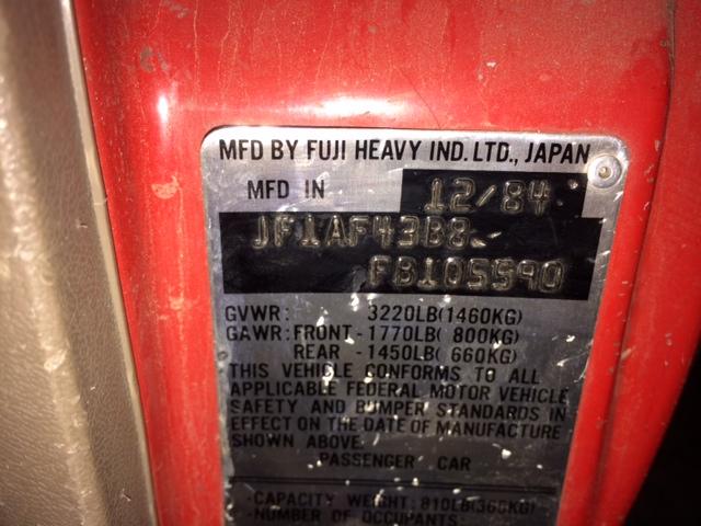

that i havent been able to find out yet. that cluth is bad so i havent even driven it yet. when it comes to finding the correct axel, where in the vin number are parts dealers refering to? for the gl i see a vin: 4 and a vin: 5 selection for parts and both numbers are in the vin

Vin 4 for the part supplier. And stick with the Model year of '84 to insure you get correct parts. The EA82's came out in '85 and the parts get crossed up at most places.
thanks. that makes it soo much easier to find parts :lol:
