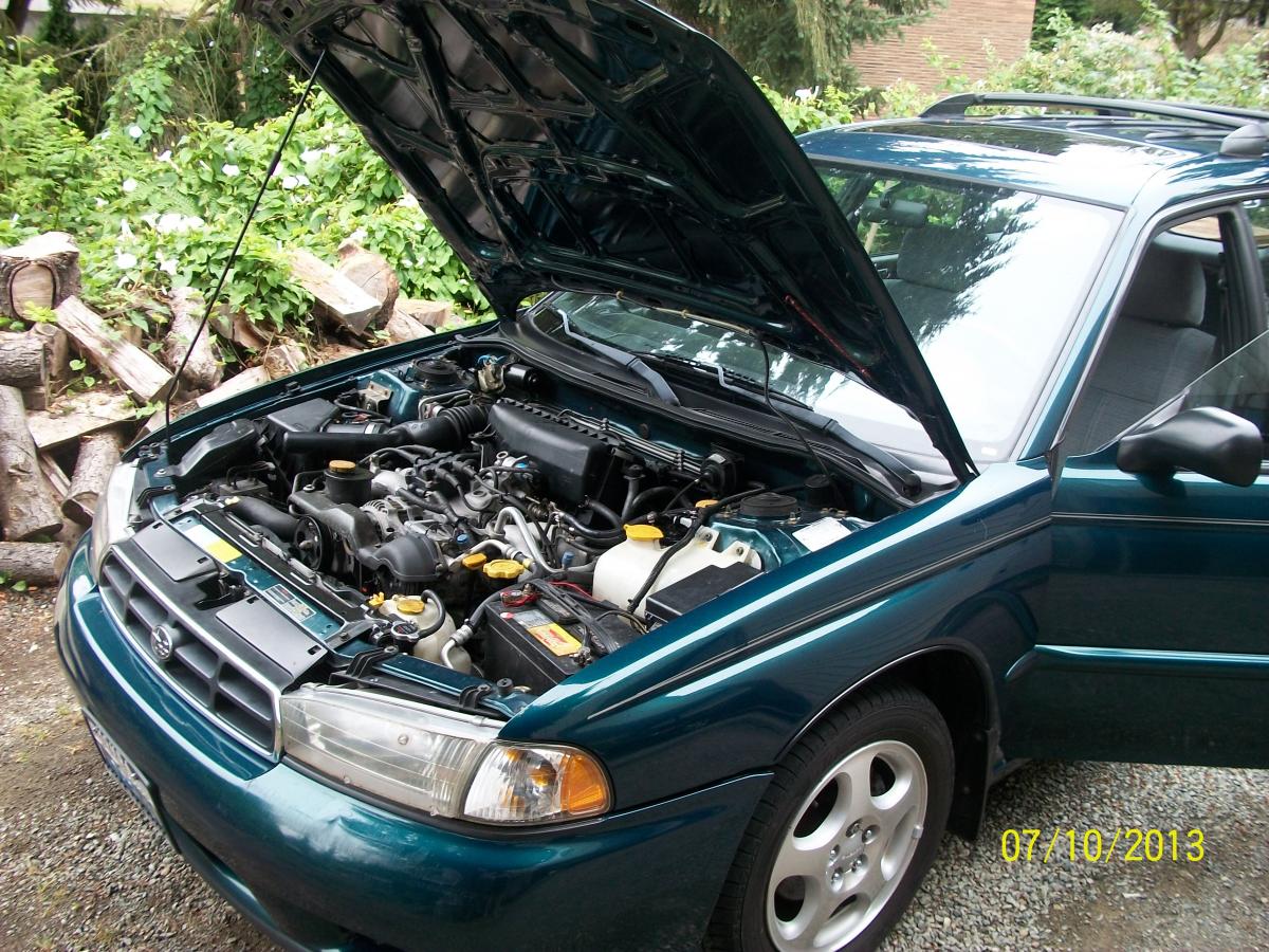

Just do what i did. Keep an eye on Craigslist for any EJ22 engine you can find. I got very lucky and found a 94 Impreza engine (complete) for $160 w/224K that had already been pulled and was sitting on the floor of a local fellows garage. I tore it down to the shortblock and put it in my 99 Legacy with some new triple steel HG's last summer and it still runs great. My 99 had a spun rod bearing on No. 1
