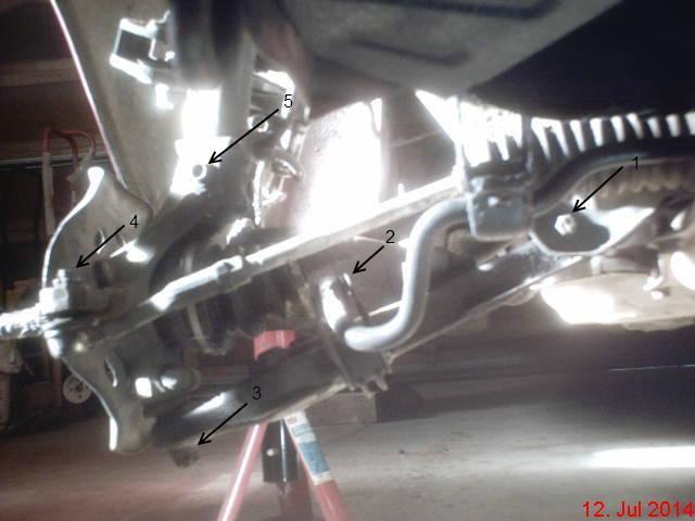

1990 Loyale sedan, under the passenger side front end, looking at the axle:
Which of these 5 do you remove to get the axle off the transmission stub ?
1 and 2.   Requireing, two, 14mm and 12mm wrenches respectively.
also helps to remove the 2 radius rod bolts to let the arm drop down and ease reinstall.  17mm nuts, 19mm heads.
2 radius rod bolts -- which are those ?
On top of the control arm between 2 & 3. Just visible in your pic.
I usually remove the bolt above 3 ( balljoint pinch)  less to undoo and then the whole unit moves about
Those are often stubborn in rustbelt areas......and the balljoint can be damaged.
And after TOO many prys and pinches, the casting can crack......ask me how I know ;)
I'm with Scott, I always pull from the ball joint pinch bolt. Even on newer subarus. But in california it rarely takes more than a nudge to release a BJ. A floor jack helps reinstalling the BJ, but be mindful of the threads.
The 2 radius bolts suck to remove imho, I never touch them unless I have to.
Just 3 ?  no others ?
Well, I removed 1 and 2 and got the axle out.  Not too bad to do it this way.  Next time I may try just removing 3.

Not 3, the bolt above 3. It will allow you to separate the spindle from the ball joint. The balljoint slips into the spindle and is pinched with that bolt above #3.
It's not very easy to separate the control arm from the balljoint (if you tried #3) with out a BJ tool and BFH.
If this is your first attempt taking the front assembly apart.. perhaps using Gloyales method would be better.

My bad I understood what you meant but used a wrong reference.  I did follow Gloyale's method this time.

Success! There are always more than one way to skin a cat, I prefer nailing to a tree and using vice grips (catfish).
You can replace it miles fox style still attached to the car. I always pull the spindles and do them on the press (instead of BFH).
Newer subarus it is easiest to mark and removed the 2 bolts that hold the knuckle to strut.  I digress
On EA's the BJ is often very hard to get propely back into the hole in the knuckle once the axle is back in.  They can get cocked and stuck going back in.....epsecially in "over stock" lifted rigs, or in rusty areas........worse if both....
And plus for me it's just the cast knuckle issue.  Cast knuckle should be spread/clamped as few times as possible.  That is why I do them the way I do now.  Seen 2 broken ones from repeated prying/clamping.
2 radius rod bolts can be easily zipped off with a 17mm socket on an impact or wratchet,  and a 19mm wrench.......takes less than a minute.......You don't need to remove the bolts either.....just need to take the nuts off and drop the arm down.
How can that be harder than the pinch bolt fight?  Hammering in a screwdriver to wedge it open, bangin, spraying PB blaster, banging again to fight the arm out the bottom  (which it doesn't want to do without removing swaybar links and radius rods anyhow)
No thanks.  But to each there own method to skin this cat.

I had to remove bolt 4, the steering knuckle.  Turns out it was quite easy and I should have done that in the first place -- live an learn.  With 1,2 and 4 open, the axle install on the trans. stub was no problem.
