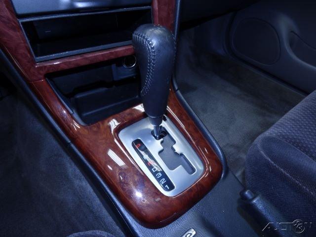

It does not do it if I use the manual mode the GT has or 3 in the selector.  So the tranny is trying to go into OD/4th to early all the time.
