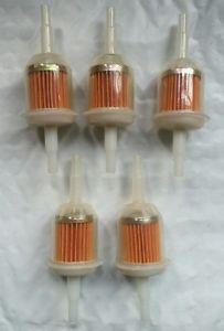

Fairtax4me Posted May 4, 2016 Share Posted May 4, 2016 There's a small filter before the pump? What kind? How small? I would bypass the first filter and see what you get for pressure without it. Quote Link to comment Share on other sites More sharing options...

Fairtax4me Posted May 5, 2016 Share Posted May 5, 2016 Yeah I suppose it could be stuck in open loop if the second sensor just isn't getting hot enough to create a voltage signal. Pretty sure other people have not had any problems cutting out the second sensor. I would still try it without the first fuel filter. Those little lawnmower filters don't have high flow rates. Worth a shot and doesn't cost anything to find out. Quote Link to comment Share on other sites More sharing options...
heartless Posted May 5, 2016 Share Posted May 5, 2016 i have to agree with fairtax - pull that filter out and see how it goes. just get a simple hose barb of the correct size to put in place temporarily - those little filters can be quite restrictive. Quote Link to comment Share on other sites More sharing options...

Sube Buggy Posted May 8, 2016 Author Share Posted May 8, 2016 (edited) okay i removed the filter and it didn't really make a difference i'm surprised the inlet on those are pretty small. Any who i finally got some codes!! never thought id be happy about it they are as follows in order listed on the tool. p0500: Vehicle Speed Sensor Malfunction (its not reading speed anymore????) p0133: (Has not appeared after reseting ecu, also unsure how old the first o2 sensor is) Oxygen Sensor Circuit Slow Response (Bank 1, Sensor 1) p0443: evap canister (don't care) p1702: Auto Trans Diagnosis Input Signal Circuit / wtf is this one?? i've been reading and it seems semi related to my bogging issue and speed sensor issue since maybe the ecu thinks the cars in neutral and not under load? hence the speed sensor not working or showing any speed? I did test the speed sensor it has 12v hooked to ignition and is grounded also has 4.73 ish volts when the ignition is turned on. unfortunately i don't have a scope to see the digital output.. Edited May 9, 2016 by Sube Buggy Quote Link to comment Share on other sites More sharing options...
