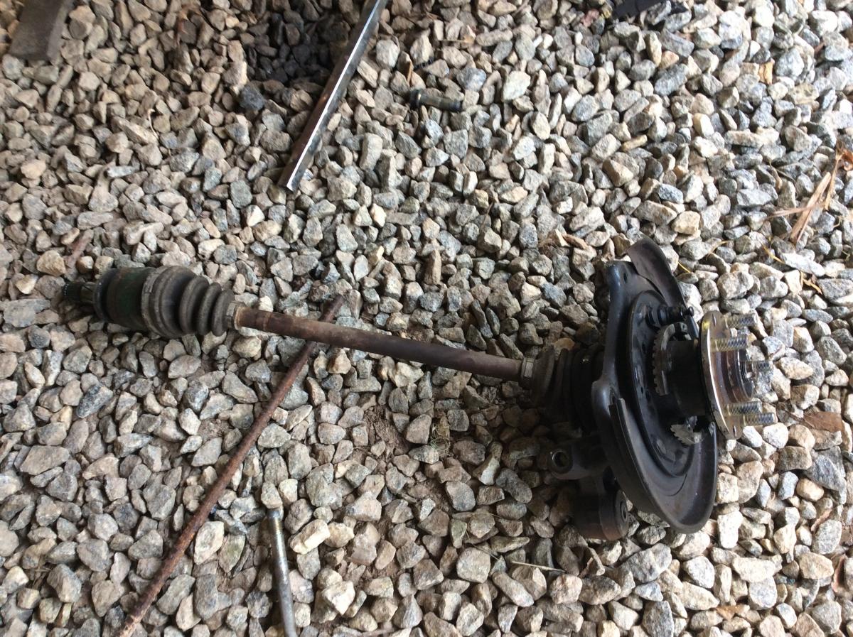

help!!!!!!! How do you remove the rear cv axle from the hub, this thing is stuck tight I took it out the differential thinking I would get better leverage its frozen.I even took the bolts out holding the dust shield in place can't find any helpful information on the interweb. This is on a junk car I'm taking the rear brake assembly off to convert my rear drums to discs. I'm new to forums, hope someone can help. Also I broke the gear piece on the opposite side of the studs with the slide hammer on accident oops!

That one doesn't look all that rusty. Spray it with some PB and let it sit for a few days.
