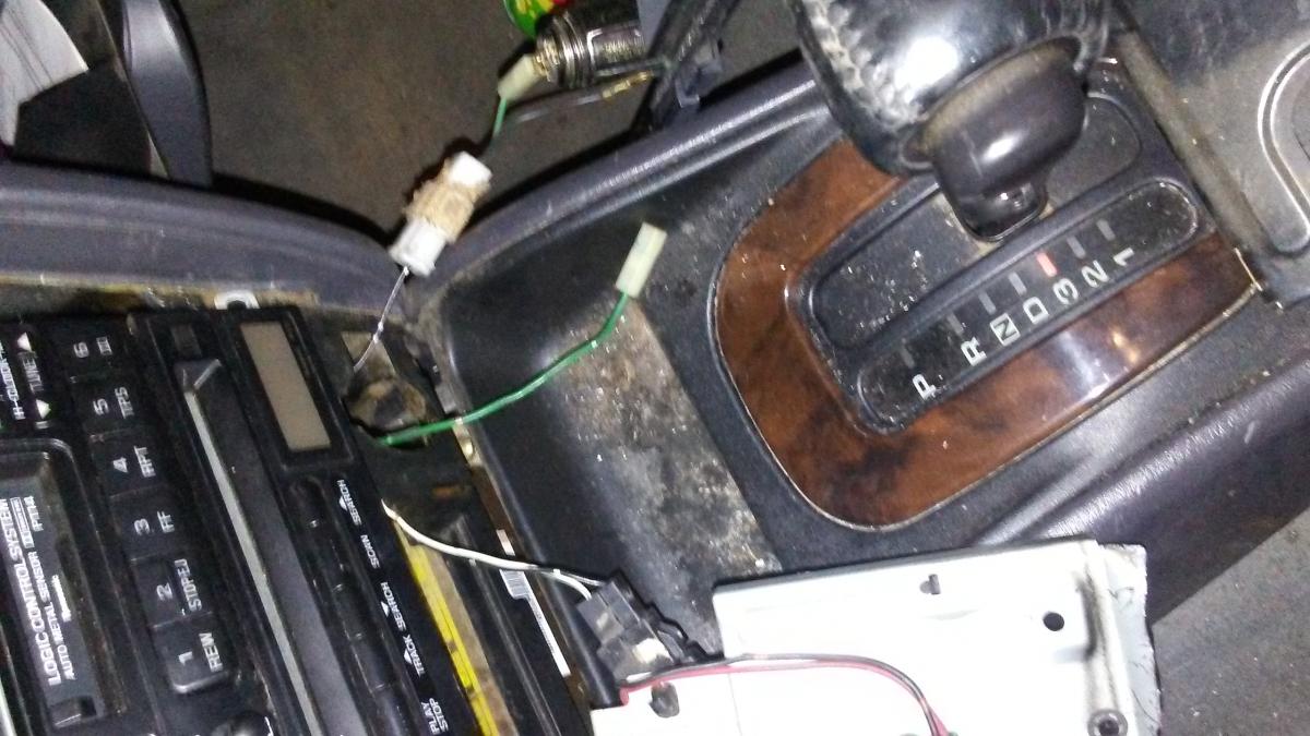

So my legacy cigarette lighter is not working could this wire cause the problem. What does this green wire go to?
Have you checked the fuse to see if okay. Don't know what unattached wire is for, but bet it is not for cig lighter. Check the power lead to the cig lighter for voltage with a meter or test light.
i see the problem now. unplug the green wire that is attached to it currently and then plug that loose green wire in where the other one was. i dont know why subaru did that but that green wire thats with the black wire does not go to anything it ends at the plug. the loose green wire is the actual power for the lighter.
