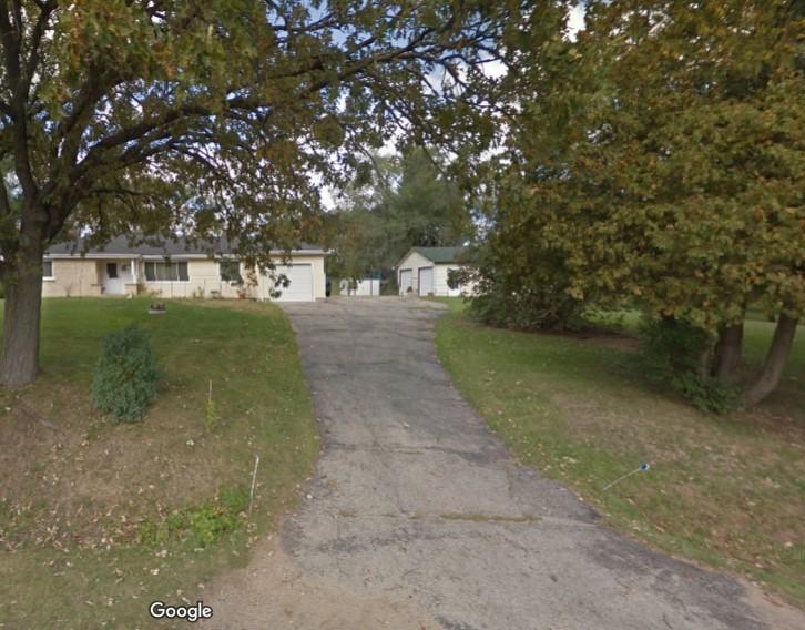

Last winter was the first winter I had it. I came from an 02 Trailblazer. With the Trailblazer I could have up to about 6 inches of snow and plow up the driveway with it.  I was told by another Subaru owner they had no problems driving in high amounts of snow.  We have a drive way with an maybe 15-20 degree gradual incline (included attached photo for reference).  This past winter with 5 inches I had issues getting up the driveway.  Since my husband is away most of the week for work, and I can't start the snow blower I usually just shovel to the attached garage since it's a smaller and shorter distance. Normally I'd drive the vehicle up the driveway park it in the garage and shovel.  This past winter I got stuck and had to shovel around the car in order to get up it.  I also had almost new tires on it as well.
