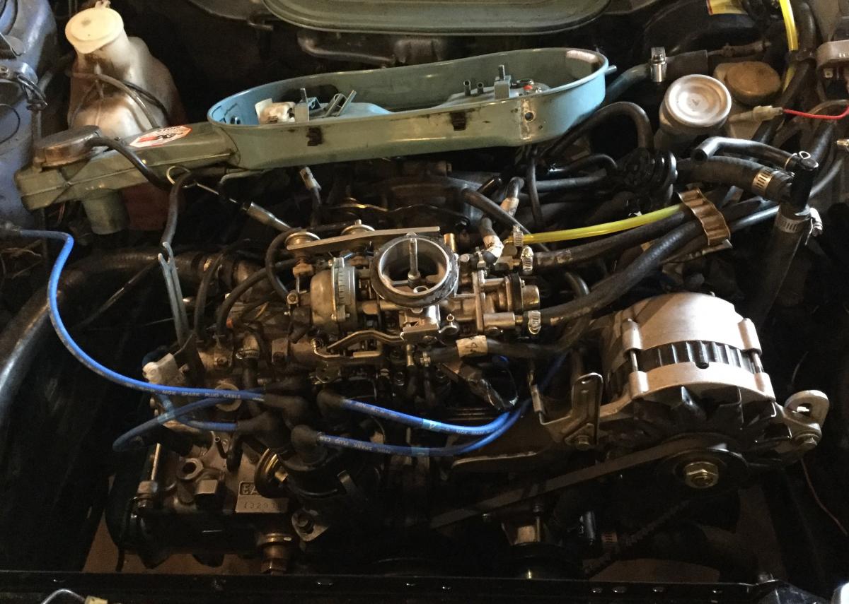

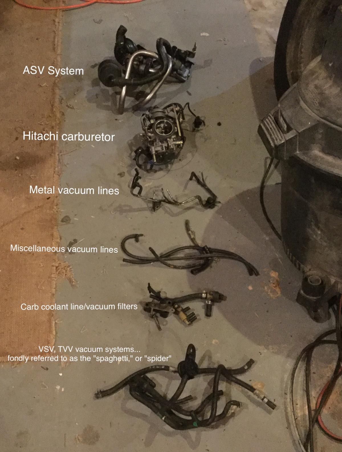

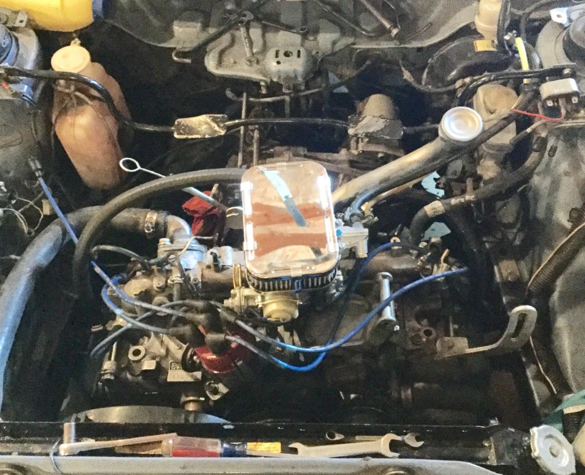

Sapper 157 Posted December 21, 2016 Author Share Posted December 21, 2016 (edited) Here are a few pics for referance: What the engine compartment will look like before the conversion: All that can be removed during the conversation (EGR can also be removed but is not pictured) What your engine compartment will look like after the conversion (sorry for the poor pic): Edited October 31, 2017 by Sapper 157 Quote Link to comment Share on other sites More sharing options...
