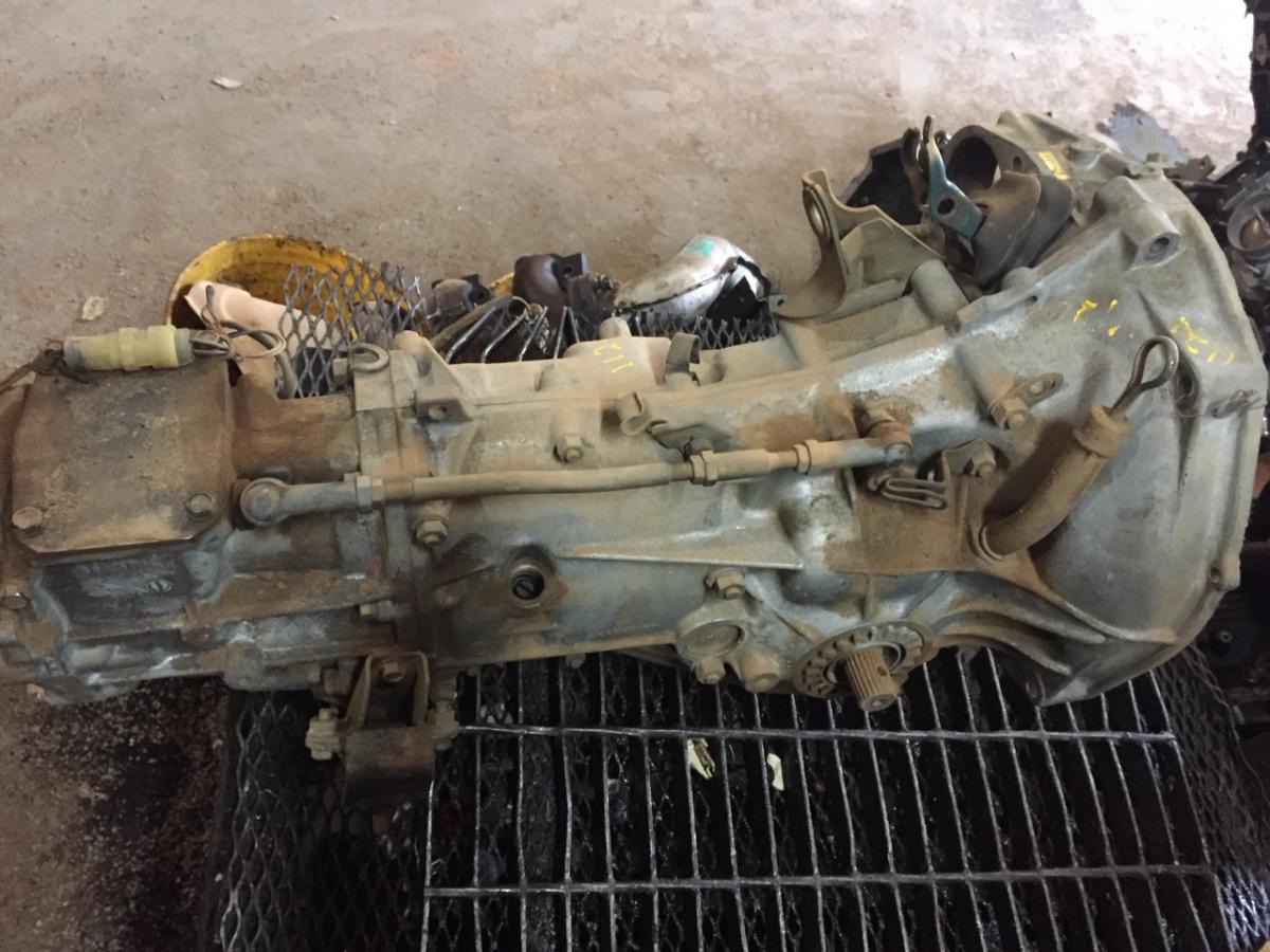

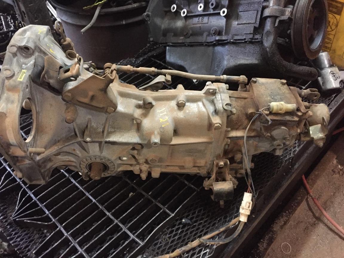

Is this transaxle dual range?
Need help with ID. Is this a 3.9 dual range transaxle?
yes it is!the long linkage arm on top controls the dual range.
Edited by Torry33
It definitely is a 5-speed dual Range. I'm not sure I know the center diff housings well enough to rule out an RX FT4WD trans, which would be a 3.7. Those are very rare.
Count splines on the stubs to determine if it's a 3.9 or 3.7
23 splines, would be from an 85-87 Carbed GL  (no "neutral" signal switch)
25 splines would be from an 85,86 MPFI Turbo car.  3.7 ratio
.....except then it would have a neutral switch for the MPFI, so I would say it's 99% likely a 3.9 ratio.  Unless the rear transfer section has been swapped. Then it could be a 3.7 turbo still if it's got 25 spline stubs
