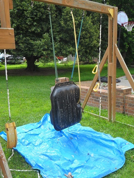

I checked all of the fuel supply, return, and vent lines, flushed them with carb cleaner and blew them out with compressed air.  There was one hard line under the bed that was plugged that is now clear.  It actually had a small bit of what looked like plastic wrap in it that I'm sure helped form the clog.
The two supply/return lines in the tank that aren't vent lines are plugged.  Further investigation shows the rusty/crustiness in the tank to be mostly varnish, so I'm going to see if I can manage to clean it out myself to the point where the internal lines are clear and it's clean enough to use.  The plan is to use a few gallons of E85 and a couple handfuls of different sized hex nuts all shaken around and rotated every so often while suspending the sealed tank from the backyard playset for a few hours.  From what I've read that should do the trick to emulsify the varnish.  We'll see where we stand after that.

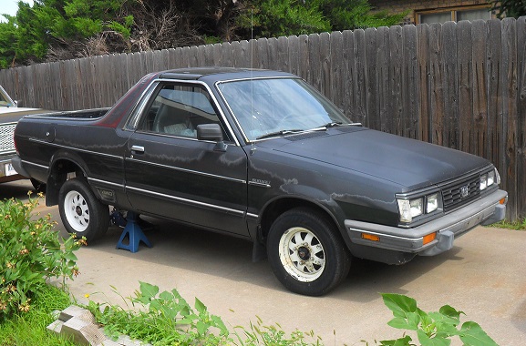

Tank cleaning in progress.  I'm amazed at how well the E85 is working to emulsify the thick accumulation of varnish in the bottom of the tank that originally looked like some sort of undercoating.  I'm equally amazed at the quantity of rust particles embedded within the varnish that we are removing.  Two rounds of soaking, agitating, and dumping are done and will do more until we no longer get any crud out of it.
Didn't take any before photos of the tank, but I have one showing it hanging from the playset in the backyard ready for agitation.  That picture is posted below along with one of the exterior.
