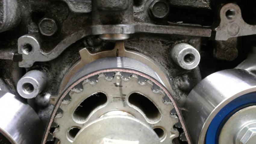

this is the mark you are looking for on the BACK side of the crank pulley - you can make a corresponding mark on the front with a paint pen for easier visibility if you like...
