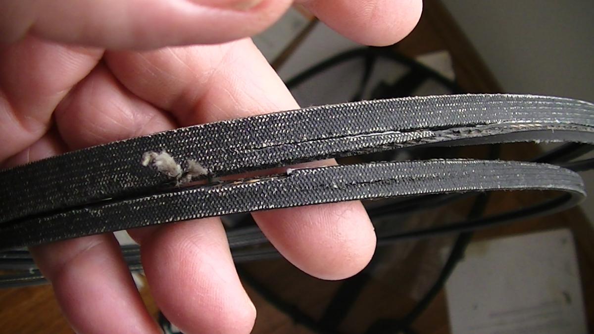

Update:  Found this.
Still disappointed - the car has only under 87K
Looks almost like a pulley cause the belt to slip for an extended period of time, wearing out the bel a little early.
Usually these newer belts last about 100k before they start showing signs of wear in the groves. But they typically don't break or shred for a while unless they were abused.
Update: Found this.
Back to my original question... How OLD is the belt?
Gates or Bando if you can find it. Dayco belts will cause you more grief.
I 2nd the turkey baster method. They use GM trans fluid for some unknown reason and it never ages well. Even if squeak is gone with new belt, fresh pump fluid will keep power steering effort smooth. It otherwise degrades slowly, to the point you can't even tell until one day it's really cold and excessively stiff in spots.
I ran my finger around pulleys but could not find anything wrong with them.
The belt is original - 87K on it.
I installed Bando from Amazon.  So far so good.
