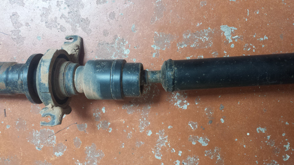

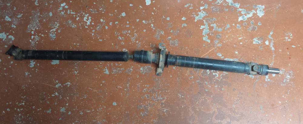

So I've got a 2000 Legacy Outback with a bad U-joint in the propeller shaft. I pulled it out but did not find the two-piece OEM shaft that I was expecting. Instead it looks like a one-piece shaft? See images.
I'm fairly certain the car has the original shaft in it. I have a good maintenance record from the previous owner and there's no mention of replacing the shaft. Did some Outbacks ship with a one-piece?
Also, if it's not OEM what are the odds this has serviceable U-joints? How would I tell other than taking it to a shop?
With the age of this car (230,000 miles) and other problems I was planning on just removing the rear half of the drive shaft and running it FWD for another year until I can afford something with lower mileage. But this throws a wrench into that plan.

That's definitely an option, right through the narrow part of the slip joint. I guess what I'm really wondering is whether it's worth trying to keep this shaft going (I guess I'd have a new u-joint welded onto the rear?). Or, if I want AWD should I just replace the whole shaft anyway. If the latter, then I'll definitely cut this one in half for now and keep the car going. Better to save money for something more reliable than keep sinking funds into this one.

Update: I started with the hack saw but realized it was going to take forever. I took it to a welding shop and it was too hard to cut with their saw so they cut it with a torch. $5 later and I'm ready to reinstall my half drive shaft.

Well, the half shaft is installed and the problem is still there. Sigh. I think my duty C failed and the drive shaft is rotating despite the FWD fuse being in. The front U-joint was in very bad shape, almost totally seized in one direction. I'm going to go put a mark on the shaft to confirm that it's rotating.

You haven't really told us what your car is doing.   A bad ujoint is going to cause vibration .. a failing duty C and clutches are going to cause torque bind,   with no driveline to the rear differential you can't feel torque bind so .... what symptoms do you have ? With it not connected to anything,  Of course the drive line still turns and your toasted front ujoint is still going to vibrate.   230,000 miles on a 2000 ob is nothing.   My personal driver is a 2000 obw 5 speed with 298,000+  I would load it up and drive to the Florida keys or New Brunswick Canada, today !   I expect if I can avoid suicidal deer and elk , and the occasional attack Turkey that that car will hit 400,000 or maybe even 500,000.   Used drivelines for that car are readily available around $100 . BUY one and drive that subi  for another 200,000 miles ,   IMO the newer Subarus are not as reliable as the older ones.  You live in the desert , no rust issues . If 230,000 scares you then look for a different one with lower miles.
