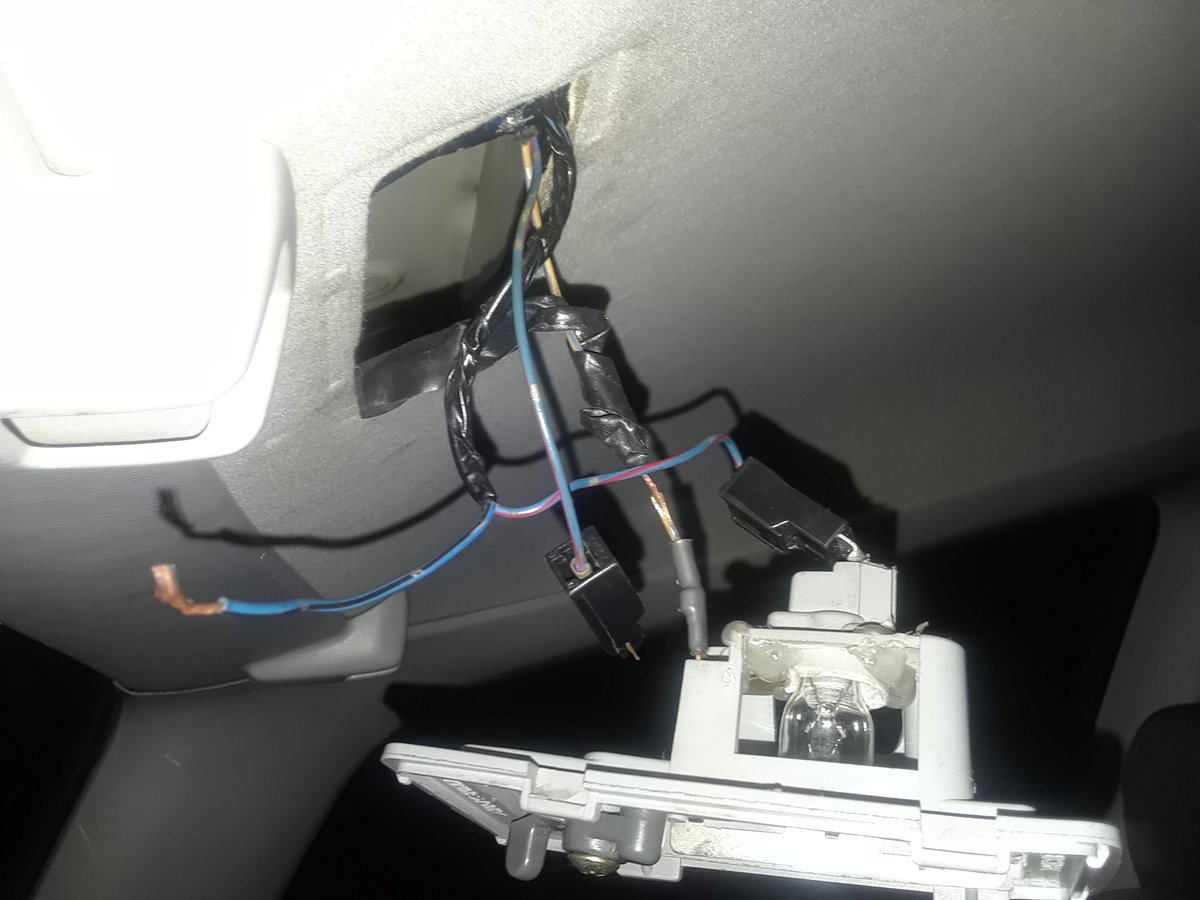

well i replaced the whole light assembly with a known working one and i still have no door light function from the rear light. it works with the switch on but not on door still. i did notice the front light comes on when i open the hatch today as well. as a side note i took the one from my moms car and put it into my 1998 outback and it worked in my car. i did some more digging into the wiring and theres for some reason 4 wires under that light. 2 of them come in from the hole the light slides out of and 2 other ones coming in from the side both sets of wires appear to be factory one of them was cut and spliced into the other one.
 i dont know maby ill just add a new wire to the door switch side of the light from what ever wire it is thats working the front light so the rear will work too.

well i figured out a way to make it work. the wiring harness in the rear had been messed with before every wire at the 2 main connectors to go to the hatch was spliced and crimp connectored with tape around them. i did manage to find the gound wire that signals when the doors open at the main plug and followed it up tot he top and spliced into it / extended it to the light. 2 of those 4 wires that were at the light were not connected to anything they were simply cut off about 12 inches into the ceiling from the light.
