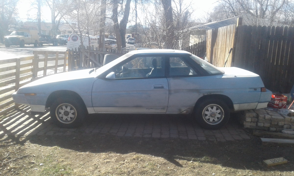

I had a 1986 leone coupe with 5 speed manual FWD, it was my first car. Gave it to my dad, he wants to convert it to 4WD (he had a 4WD leone pickup that he liked very much like 20 something years ago so for him its a real dreamy car and i think its an awesome project since it will bring that subaru back to life).
Wanted to know:
1) Could we swap parts including engine from a newer mid 2000's to start of 2010's Impreza?
2) What do we need to put in and/or swap to make it old 4WD or new all time AWD?
Would realy love to make that dream come true!
Lots of thanks to the Subaru gurus

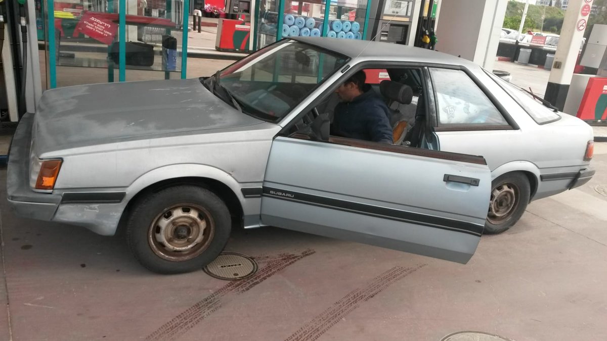

Hey nice coupe!

Make sure you leave enough in the budget to slam her extra low, and a fresh paint job...although a little patina goes a long way, yours is about perfect.
Tinted windows.
Then monster turbo. Keep the flat hood and squeeze a bumper mount intercooler in there.
And a set of those formula mesh basket weaves...on the standard non rx coupe? Sick made!
What's her name?
My 86 gl with ej22 is the baby lion and my 85 xt turbo, ghost that I am going to slam to lowlife level, like this guy...
