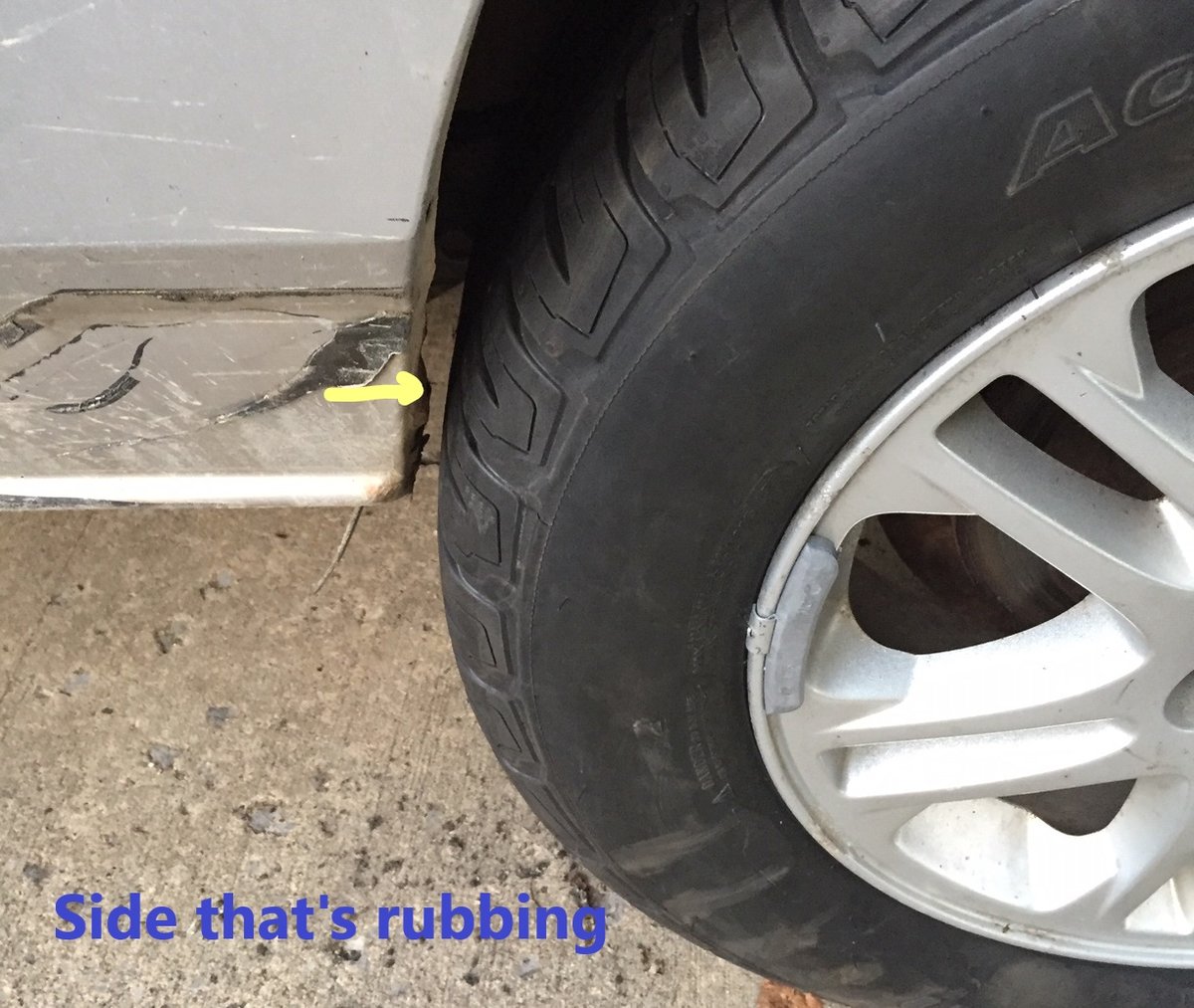

All the bushings seemed perfectly tight with no play and smooth movement as the arm articulates.  The arrow is where it's rubbing.
The gap is the same on passengers and drivers side.  With the mud flap removed I see there's a small part of the metal edge bent towards the tire.
This metal is stout - how do I bend that back without bashing it and turning it into an uneven rust haven?  Channel locks will bend the "bent part" back, but then the adjacent edges get distorted that the channel locks aren't touching, if that makes sense.

looks like theres some cutting in your future or a bigger lift
How about rolling a piece of pipe or round bar stock through the gap again & again until you have the clearance you want?
Increase size of round stock in increments of course.
