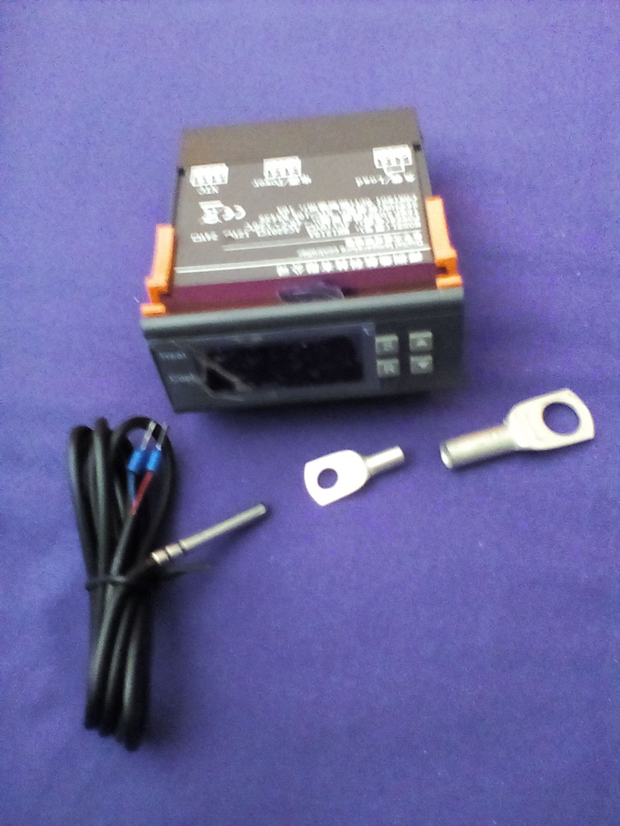

September 28, 20196 yr That tab in the middle is stamped 6-6 No idea what it means Heat shrink tubing on wire ends first, pushed back away from heat source until final step...might be 8 or 10 mm ID heat shrink The sensor just fits in where the wire should go, when drilled out to 4.0 mm I think I chop the wire crimp tube off and toss the tab bit The chopped wire crimp tube fits inside the larger terminal, no drilling I solder the smaller crimp tube inside the bigger terminal stamped 16-10, then, yes once soldered, drill out hole to suit sensor and it is tight fit Heat shrink everything up after. The hole in the 16-10 is maybe 10 mm perfect for M8 bolts on thermostat
