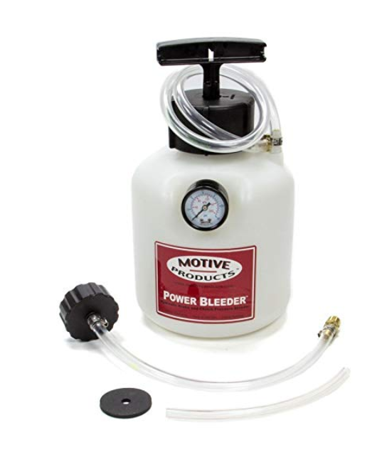

I've been  using the Motive Products bleeder for years.  It works great.  Fill the bleeder with fluid.  Hook it to your master cylinder and pump it up to about 8 psi.  Hook a catch bottle to the bleeder and open the bleeder.  Keep the bottle high.  Watch for clean bubble free fluid coming out of the caliper.  Close the bleeder.  Move on to the next wheel.
