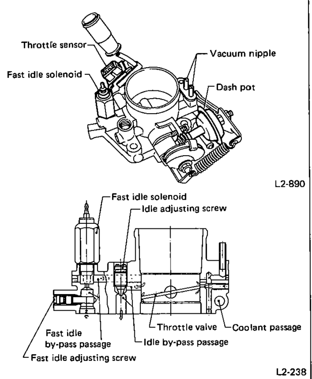

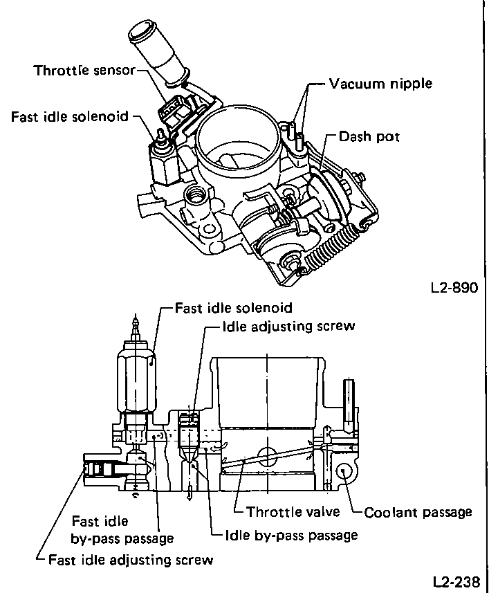

January 30, 20206 yr 1 hour ago, Glfanboy9967 said: Where exactly on the throttle body ? and reference point you could supply would be appreciated I believe he is referring to the vertical brass screw illustrated here... Be sure to verify that your idle air solenoid is working properly, as well as your O2 sensor(s). These give feedback to the ecm to control air/fuel ratio, and you don't want to turn that adjustment screw unless you know that that there are no vacuum leaks or other issues affecting your idle first.
January 31, 20206 yr 1 hour ago, naru2 said: Not quite,but,it is nearby. Much better diagram. Is that adjustment screw capped? Seems like I recall it being covered, so you had to drill the cap and pull it off. I could be mistaken.
