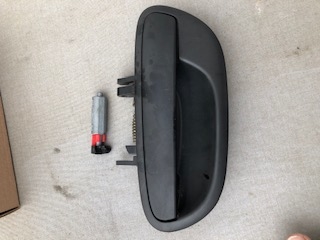

Exterior handle is broken.

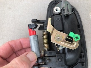

Was able to remove door card with door still locked shut. Probably did NOT have to take the skin off since I found that you can get the lock to unlatch using a long screwdriver. Easier from the door inner side but also can be had creatively from the window slot. Look for the green link retainer.

So you know , this is what happens. And the part is around $34 or so. You’ll get the entire handle as you see the old one presented here with all its assembly.
