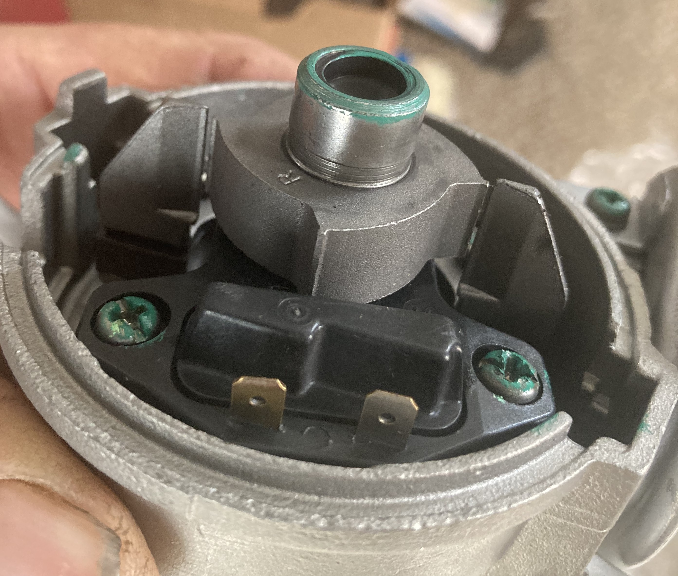

acarcollector Posted 16 hours ago Share Posted 16 hours ago Hello everyone, I'm looking for some help. I own a 1983 Subaru Brat non turbo automatic. Apparently the po installed a Nippondenso distributor at some point. According to a mechanic friend and also the shop manual it Brat's should have a Hitachi. I am having issues with it losing all spark above 2200-2500 RPM's so my mechanic friend recommended changing the coil and distributor back to factory specs. I found and purchased a rebuilt Hitachi. The question I have is that the pickup coil does not have any markings which connector is positive and which is negative. I am attaching a picture of what I am looking at. Does anyone know which is positive and which is negative? I couldn't find any info on this in the shop manual and the mechanic doesn't know either. Thanks for any help. Much appreciated. Bill Link to comment Share on other sites More sharing options...
el_freddo Posted 10 hours ago Share Posted 10 hours ago I usually go by the shape of the wiring as this is something that’s never changed in my brumby. Someone on here will know for sure. I can check it out thoroughly in a few days and report back if it’s not urgent. Link to comment Share on other sites More sharing options...
acarcollector Posted 5 hours ago Author Share Posted 5 hours ago Thank you sir, no hurry. The wiring was cut and spliced when the original Hitachi was replaced with the Nippendenso. Thanks again, Bill Link to comment Share on other sites More sharing options...
moosens Posted 1 hour ago Share Posted 1 hour ago Maybe swapped for the advance curve. That was a bit of a thing to do for some. I’m not positive that applies to yours but i seem to recall the automatics had a better advance curve and maybe FWD different from 4wd ? I would have to check a parts manual. But that was my only thought on why they swapped it out. My 79 4wd wagon was swapped out with a FWD complete engine and exhaust. So i had to decipher that at one point due to ignition parts. Same deal it’s Hitachi or ND. Good luck with it. Link to comment Share on other sites More sharing options...
