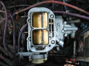

I've got the bottom aircleaner housing removed from the weber, and I see 6 screws that appear to be holding an upper plate. Can I remove these 6 screws to peer further into the carb without having to buy a whole new gasket/rebuild kit? I'd like some insight on how I can go about troubleshooting this without having to go through a whole rebuild. I'm broke right now, and with the Florida M&G coming up, I've gotta save what I can when I can.
Pics.
DSC06859 shows the 6 screws I was referring to in the prev post.
Sorry, my Weber 32/36 DGEV has an ADS.
seen next to the bowl vent

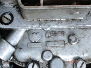

From all my other reading, I can figure out the primary and secondary mains jets, but I dont know what those three others are in the bottom of the float bowl. See attached image. (And no before yall freak out, its not real rust.. its just stains in the bowl) Which is what and what should my next step be?
Heh.. thanks Skip! That page has plenty of useful information and pictures. Turns out what I thought was primary/secondary were really the air correction jets. I will continue reading.

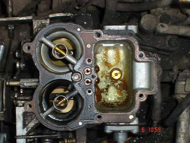

I popped the top off again to see the bowl and its contents. I removed each and every jet, and applying the same process as above. I then flipped the top over and inspected the connections, and shot cleaner through each of the passageways in the lid. I even wedged open the throttle plates, used the plastic straw attachment to shoot carb cleaner up the back side of the emulsion tube in the primary barrel.
I just finished putting it back in the Brat.. no dice. I did manage to fix the fast idle though. :rolleyes: It idled fast, skipping beats here and there, then when the choke snapped open and the idle went to drop, it dropped all the way to 0rpm. Sux.
I've got a friend thats a classic VW tuner.. if I cant get this carb fixed, I'm going to contact him to see if he's got an extra 32/36 dgev laying around I can "test" with. :brow:
I am now officially stumped again. I know not where to go from this point. May I have some more helpful guidance?
