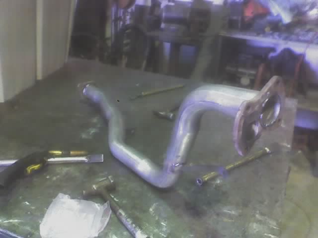

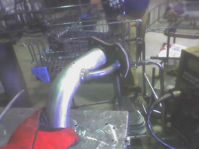

[HTi]Johnson Posted July 28, 2005 Share Posted July 28, 2005 Hey all. I made this downpipe...what do you think...I might be able to make more Oh yeah, I didn't bend the tube...I wish I could, it's too thin guage for the machines I have access to, But I had a muffler shop do the bending, I did the rest. Quote Link to comment Share on other sites More sharing options...

JWX Posted July 28, 2005 Share Posted July 28, 2005 I think the wastegate pipe should be bigger, and a bit longer Quote Link to comment Share on other sites More sharing options...

Caboobaroo Posted July 28, 2005 Share Posted July 28, 2005 I think the wastegate pipe should be bigger, and a bit longer Yeah if you could make the wastegate line longer like down to the bottom bend, then it would be a lot more efficiant. Looks god none the less though! Too bad I have a TD04 now... Quote Link to comment Share on other sites More sharing options...
DrKrazy Posted July 28, 2005 Share Posted July 28, 2005 Aye for that price you can put me down for one too! Looks pretty good, and way better than stock. Good Job...and do keep me in mind if you do start making them. Quote Link to comment Share on other sites More sharing options...
carfreak85 Posted July 29, 2005 Share Posted July 29, 2005 I'm thinking that a bell mouth for merging the wastegate might be the best solution. Even if the wastegate pipe is longer, all you're doing is moving the turbulence further down the exhaust system. The bell mouth is the same design the Cobb tuning uses on their downpipes. Quote Link to comment Share on other sites More sharing options...

nkx Posted July 29, 2005 Share Posted July 29, 2005 I think the wastegate pipe should be bigger, and a bit longer right on my train of thought! it should join up with the rest of the exhaust farther downstream. Quote Link to comment Share on other sites More sharing options...
[HTi]Johnson Posted July 29, 2005 Author Share Posted July 29, 2005 this downpipe is 2.25" od that's a significant increase from the what 1.5" I.D. of the old exahust. THe stock pipe looks big, but it is a pipe with a heat shield. This downpipe provides more flow than stock...considering how the stock one has a huge catylitic convertor on it. Quote Link to comment Share on other sites More sharing options...
