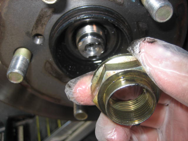

So today I ran into the fact that my new axle had no chamfer on the pin hole. After ispectin closely I found my chamfer side runs through the middle of the spline and the other side runs through two splines. I carefully marked it and positioned it up and that part is done. Today's big problem seems to be that I can't get the new axle all the way through the hub. I cleaned it and lubed it but I don't have any threads showing at all. Subaru says use thier tool and adapter to pull it in which I'm a bit short of. I'll go to lunch and see if things improve later.
I think you mentioned earlier that you had a Forester so you should have splines at the wheel/hub end. Lube the splines to make life easier; the fact that you had so much trouble getting the old one out makes me think there was some rust build that's still interfering with this. If you can get the axle far enough through to put the castle nut on for 4 or 5 turns, you can use it for a pinch point and using two large screwdrivers, pry the stub axle out a little at a time. I have 6 large washers that I used to use to put under the axle nut to get me a little further each time until it finally came all the way through. I'm still trying to get my head around the fact that your axle is so difficult to get out and get in again.

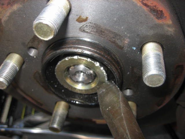

My solution was to turn the new axle nut around and use the thin end as a puller. I hit the edges with a screwdriver to turn it like you would to start a frozen nut or something you don't have a wrench for. Luckily it was long enough on the thin part to get a good grip on a couple of threads. I could have welded an old axle nut to it to turn it easily but then I'd be short a nut. If I did this every day that's what I would have done to make the next one easier.

before I tried to put the new axle in I removed all rust and lubed both axle and hub. This was still a press fit.
