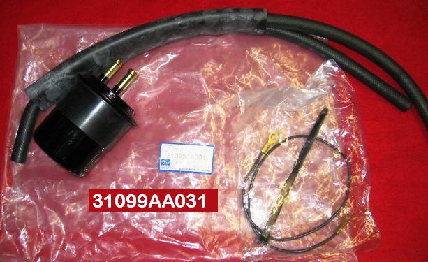

piney? Maybe someone poured pine-sol in there, like they read it was good as an auto trans flush. If you buy it I'd change out the ATF with fresh good quality ASAP. Also make sure it has the external aux filter installed.

hehe, right on, and welcome.gif. If it seems to be shifting fine etc I'd just change out the fluid after you buy it and make sure the external filter is installed (it should be in the LH/driver wheel well area); here's the kit:
