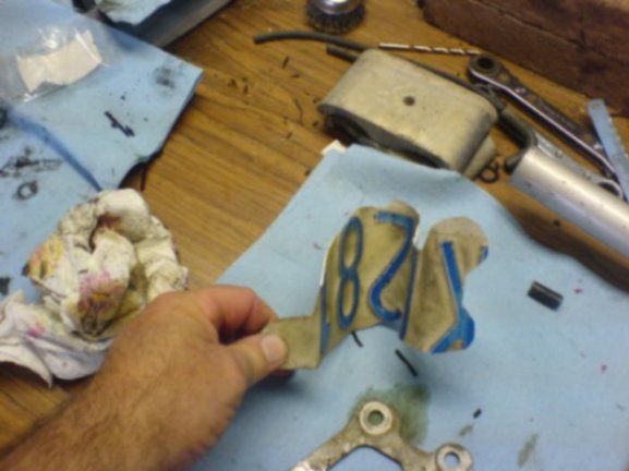

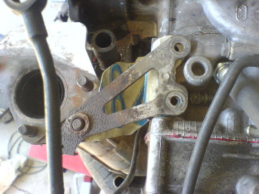

OK. I didn't reroute the hoses after all. That would have taken too much time running around to get parts. So instead I fabbed a heat shield out of an old liscense plate I had laying around.

This is what it looks like almost installed.

That hose is supposed to have an aluminum heat shield on it from the factory.
Only problem I can see with the exhaust wrap is it's bulky. Could be hard to get the hose into place with the wrap on it..
I had considered loosely wrapping the hose with aluminum foil, and I still might do that.
