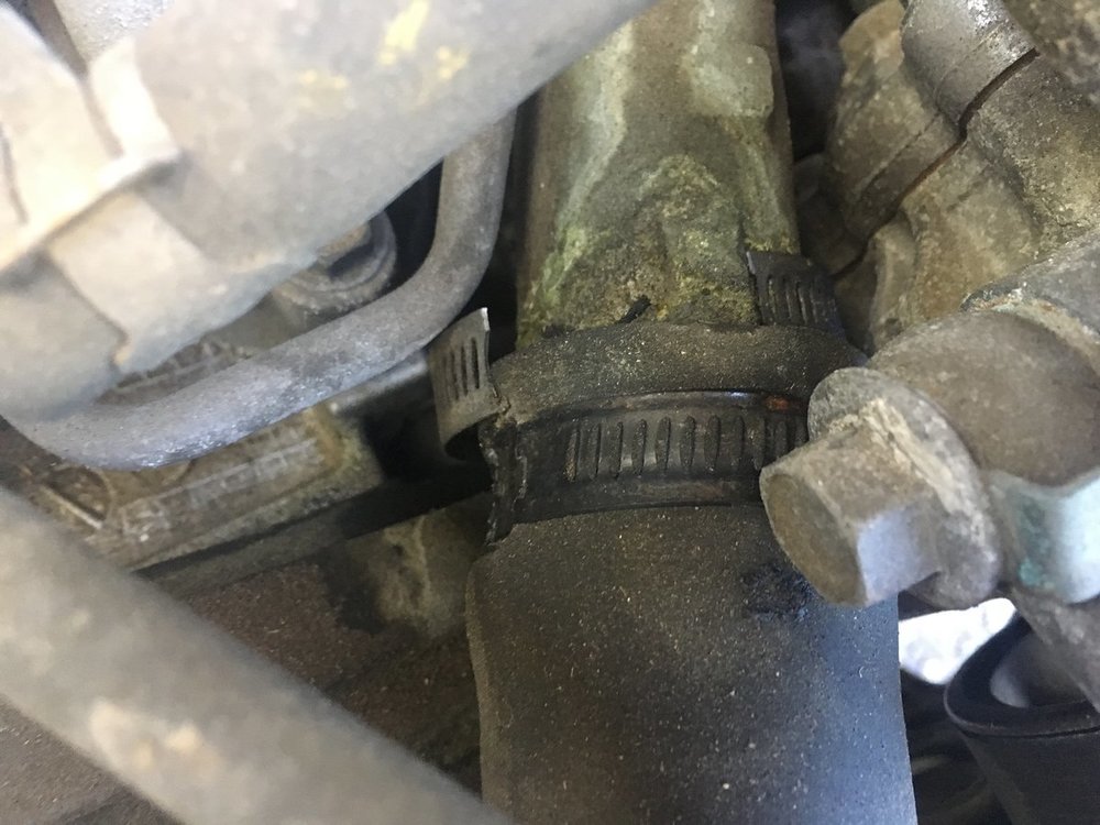

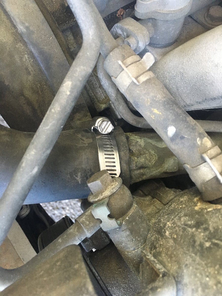

Thanks for saving me a lot of grief and money.  Coolant was coming out from the timing belt cover on the passenger side, and as you suggested, the radiator hose was leaking.  The radiator hose clamp broke and I guess it was installed by the previous owner, who replaced the engine with a newer one, but of course all the hoses are quite old (1999).  It's not leaking anymore since I added a new hose clamp.  Luckily I only drove 2-3 miles while it was leaking.  Guess I should try to use an OEM clamp instead of the hose clamp.
Awesome. Hoses could be bad or those clamps or the hoses could be low quality aftermarket.
sounds like you got it. If you have more issues you might consider new Subaru hoses and clamps as they’re higher quality and checking to make sure the radiator isn’t cracked. The part the hose slides onto can sometimes crack or break. I’ve seen some where the hose only fits over a couple millitmeters of the radiator, less than the width of the clamps and that’s with stretching the hose a little. Not an ideal long term situation.
