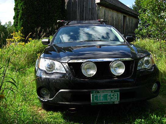

BrightLights Posted August 25, 2009 Author Share Posted August 25, 2009 I assume BrightLights isn't yanking our chains.... I assure you I am not. I went through a lot to mount the lights and to try to troubleshoot the install. As of right now, I have beautiful Cibie lights fully mounted and wired (except for the *one* wire), and they are for the time being purely ornamental. You can all imagine, I am sure, how frustrating this is. I'll take a picture and post it tomorrow or Wednesday. Quote Link to comment Share on other sites More sharing options...

BrightLights Posted August 31, 2009 Author Share Posted August 31, 2009 Progress is being made. I have answered the question I posted, but that has led to another, which I hope you can help me with (it's far less mysterious). First things first. The solution to makeing the car start with a new wire attached to the battery "+" terminal turned out ot be very simple (I went to town yesterday and bought heavy duty aluminum foil and large alligator clips, but this turned out to be unnecessary). The car goes through a little self-test routine when you start it. All of the guages go through their full sweep and all the warning lights come on, then go out. When you start the car normally, you shoot right past the "accessory" position on the ignition switch to the start position. *After* the car turns over and starts, it goes through its self-test routine. I was never getting to this point because the car would not start with the wire connected to the battery. The solution was to connect the wire from the battery to the relay, then turn the key only as far as the "accessory" position. The car went through its self-test routine with the key in that position. I turned the key to "off", then started the car normally. It starts normally every time now with the wire from the battery to the relay connected, so that problem is solved. But I have encountered a problem wiring up the trigger circuit. The driving lights must, by law, be wired to come on and off with the car's high beams. I *thought* I had the correct wire tapped. The high beams each have a push on connector with two wires, one white and one green. I pulled the connector, switched on the brights, and used a circuit tester to determine that there was voltage between the green wire and ground and no voltage between the white wire and ground. So I tapped the green wire. Logical enough, but apparently wrong. After solving the no-start problem, I discovered that the driving lights came on with both the low and high beams (though not with the headlights turned off). So I investigated further and found that there is voltage between the green wire and ground with *either* the high beams or low beams on, and voltage between the white wire and ground *only* with the low beams and not the high beams. Can anybody help me determine what wire I should tap as the trigger voltage for my relay so that the driving lights come on with the high beams but not the low beams? Many thanks, again, for any help. Here is a picture of the mounted lights: Quote Link to comment Share on other sites More sharing options...
