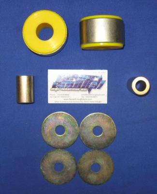

Here are the 49191 Nolathane inserts I purchased:

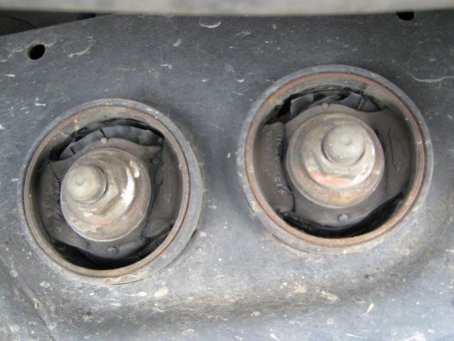

Here are the bushings, they are completely torn, allowing the diff to move up/down and forward/back with little to no resistance (wet from penetrating oil):

They needed to be trimmed. They will have to be narrowed and shortened. How much will depend on your vehicle and the condition of your bushings:
