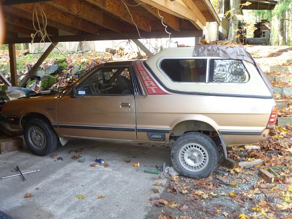

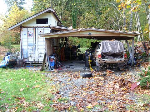

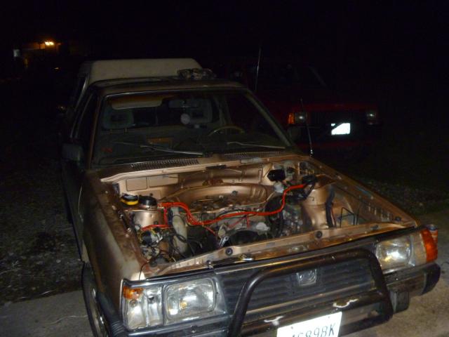

bunch more pics.!!!
got a 4 inch lift kit. it is nice, but i got it half on, and was like, "damn, thats too tall for me".
got my ej18 totally hooked up, at least in the mechanical sense. the wiring still needs a few details smoothed out.

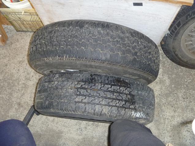

anyhow, heres some more pics.
the tires are a 185-75-14 on 14 pugs. and a 215-75-15 on 15 pugs.
the stock, as you probably know, are 185-75-13.
so i went from 23.92 to 24.92 to 27.69
the new 15 tires are just some used republic ensigns from craigslist. i paid 80 bucks. i want to get some discoverer atr in 215-70-15.
they would be 26.85.

please tell me you are using more than a cinder block for supporting this while working on it....ie jackstands do not crack in two like a cinder block will and collapse.
http://www.ultimates...00&d=1320367100
#22 tallwelder81
tallwelder81
    Eat, Live, Breath Subaru
  • 276 posts
  • maple valley
Posted 04 November 2011 - 01:29 PM
well, TWO blocks. and yea. i have 4 jackstands. and they are all harbor freight garabage. honestly, i would trust a styrofoam cup more than the jackstands i own.
and i appreciate your concern. i realize the blocks weremt ideal.
but i am super buff. if the car falls, i will just benchpress it, and throw it into the next county!!
GRRRRRRRRRRRR!!!!!!!!!!!!
lol....
i am hoping to, at some point, get a used lift for my garage.
trueblue got me spoiled with the convenience of a nice lift.
i did my exhaust on his. and we kinda started the bullbar, on his lift, also.
