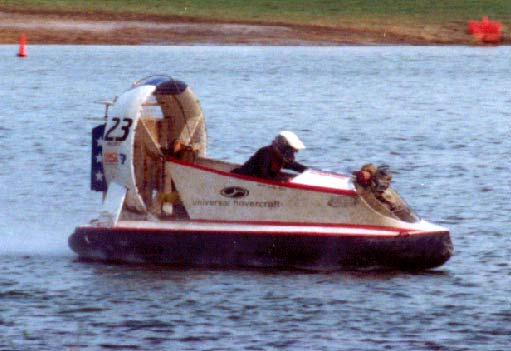

so I'm reading this thread ,getting curious?then I come across this picture and I say to my buddy "what the hell is this guy building?"so my reply is "hell if I know why don't we ask." so we are, what is that your building?
#7 DJ_Kuehn
DJ_Kuehn
    USMB Regular
  • 50 posts
  • St Louis
Posted 16 April 2004 - 01:56 PM
hehe, I was afraid that question would come up :)
I build and race hovercraft. I'm converting my craft from 2 extremely moody 2-strokes to a (hopefully) not moody and very reliable soob. Attached pic is the craft I'm going to try the soob on.
#8 LUVMYBRAT
LUVMYBRAT
    Subaru Nut
  • 589 posts
  • Laramie
Posted 16 April 2004 - 02:02 PM
Cool, we guessed air boat,close huh! So the belts going up drive the fan to push the boat and the one going down drives something?that inflates the surrounding tube to make it hover?
#9 DJ_Kuehn
DJ_Kuehn
    USMB Regular
  • 50 posts
  • St Louis
Posted 16 April 2004 - 02:09 PM
Yeah, pretty much. Here is where that first pic came from.
http://www.zbcreations.com/our18sp.htm
It's the website of another hovercraft guy I know. That craft is much bigger than mine, but it works pretty much the same way. The soobs are used on the bigger craft all the time, I'm just going to be the first (as far as I know) to race one. Or for that matter, to even put one on a craft as small as mine (13 ft).
