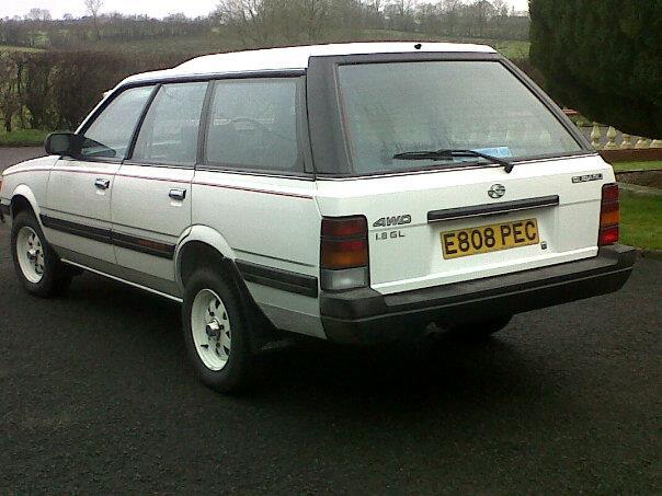

This is my 1986 ea82  l series wagon, 42K miles when I got her.  I recently gave the body work a tidy up,{with the help of my bro in law} with new rear arches and a general clean up. At the minute, im stripping the power steering of a  1991 ea71 saloon l series parts car I have for my wagon. This will be a great improvement , and leave it easier for the wife to drive too !
   The back shocks need replacing, and a set of 4runner fronts will go in soon. Also have an xt lsd in the garage for her which will go in straight after the power steering. Cant wait to feel the difference with these two upgrades.

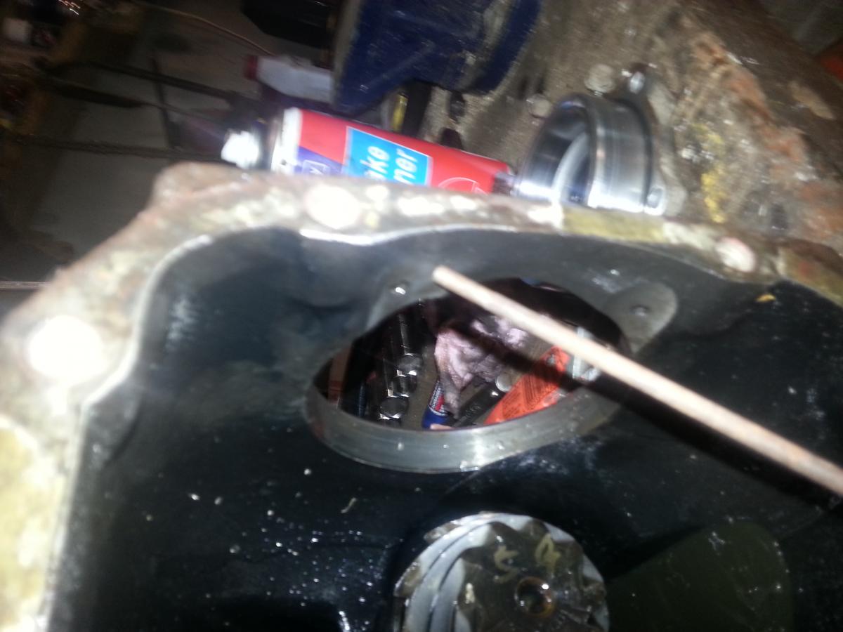

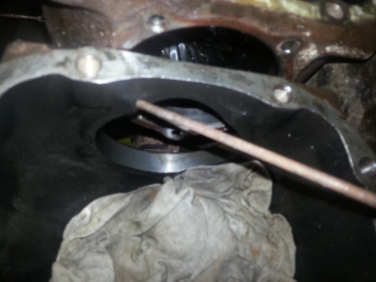

Finally got my lsd fitted on Wednesday. It's from a subaru xt turbo which had 3.7 ratio. I had to grind the inside of my 3.9 case to get the lsd in there, definitely wasnt going in otherwise. You can see in the pics where the 3.7 case is already modified to get the lsd in, and the 3.9 has four humps that need ground offAttached File  20131218_175406.jpg   85.51K   36 downloadsAttached File  20131218_175415.jpg   73.23K   36 downloads
The unit I got is in great condition thankfully. I suppose they cant really come to much harm behind a lite little 130 bhp car! The extra grip is definitely noticable with the car in 4wd :)

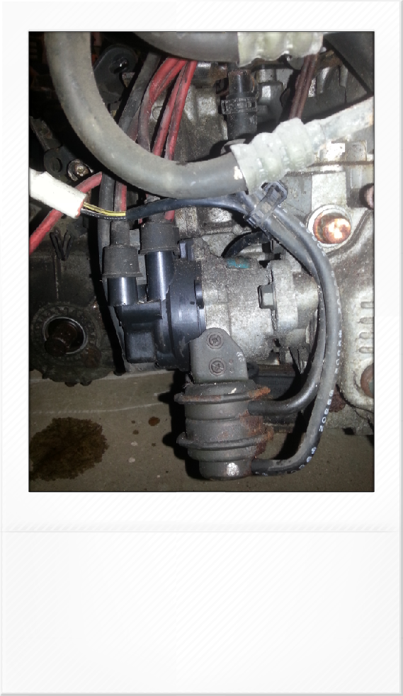

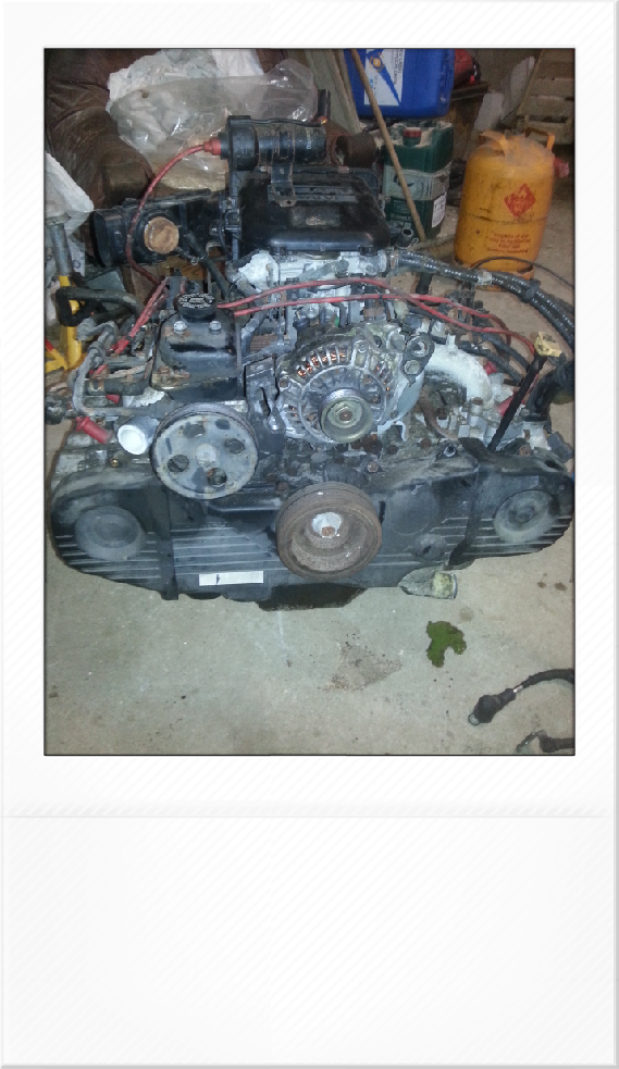

I picked up this ej18 carburettor engine today from an old subaru dealership. Hope to get in into my L series within the next few weeks. Some pics -
The factory Carburated EJ engines are Awesome! ... The LADM (Latin American Domestic Market) received EJ15 and EJ16 carburated on first gen impreza, also EJ18 and EJ20 Carburated on First gen Legacy; here is a Video of a Local (Honduras = LADM Specs) Dual Range carburated EJ20 Legacy I was about to buy, years ago:
People in USA never received Carburated EJ engines, nor Dual Range EJ transmissions, as they weren't available for USDM only... I know many USMB members will pay to receive the intake manifolds & Distribuitors from carburated EJ's in USA, but despite that the Distribuitors could work, the intake manifolds looks different from their EFi Counterparts...
There are two different distribuitors for EJ's, one is for the smaller displacement ones (impreza), and the other for the Larger ones (Legacy), I have the part numbers if you need them...
Kind Regards.

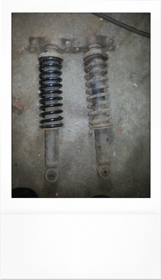

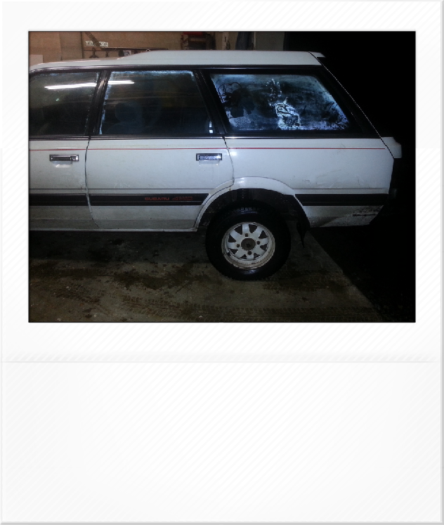

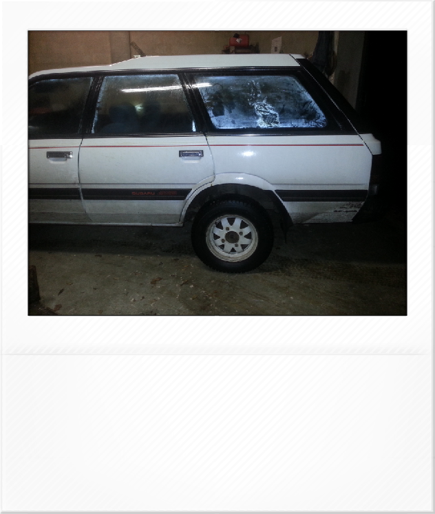

swapped the rear subaru coils out for the new boge accord springs.
Below is the car with tokico landcruiser front shocks and subaru springs in the rear.
Attached File  image_07.png   342.99K   33 downloads
And now with tokico shocks and boge accord springs.
Attached File  image_06.png   330.77K   38 downloads
And a pic showing the old subaru spring on tokico v's new accord spring on tokico shock.
Attached File  image_05.png   482.32K   31 downloads
There is a slight lift from the new springs compared to subaru ones.

Yes, the shocks where used, but in good working order. The boge springs are nice and firm , and required no cutting to get on. They where listed for manual transmission accord with 1.8 or 2.0 engine.
The stock subaru items would very occasionally bottom out with tokico shocks, I can say this is now eliminated with accord springs.

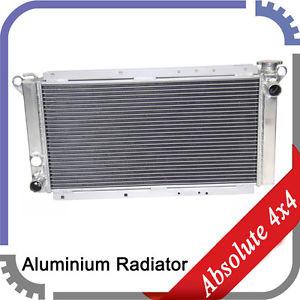

Nice radiator here for the ej swap I think-
Attached File  $_35.jpeg   17.44K   4 downloads
Its from an early renault 5 turbo. The core measures 535mm x 288mm x 50mm.

Did the Renault Radiator fit there?
