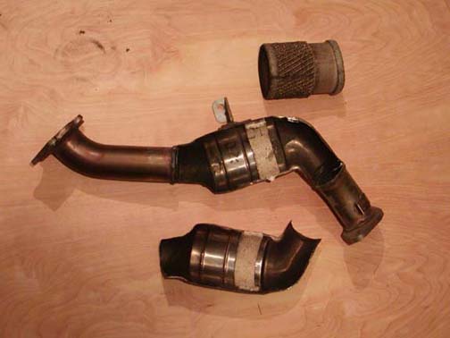

Warp3 Posted April 22, 2004 Share Posted April 22, 2004 gut BOTH cats Much easier said than done on the one in the downpipe. Any suggestions for this cat (other than the cut open, peel back, gut and reweld suggestion that I've seen in the past)? But you are correct...turbo cars want the mostly freely flowing exhaust you are willing to give them (unlike N/A cars which need appropriately sized tubing as too large will kill exhaust velocity and reduce scavenging at lower RPM). Quote Link to comment Share on other sites More sharing options...

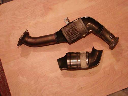

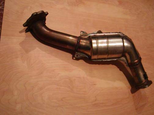

garner Posted April 22, 2004 Share Posted April 22, 2004 Much easier said than done on the one in the downpipe. Any suggestions for this cat (other than the cut open, peel back, gut and reweld suggestion that I've seen in the past)? But you are correct...turbo cars want the mostly freely flowing exhaust you are willing to give them (unlike N/A cars which need appropriately sized tubing as too large will kill exhaust velocity and reduce scavenging at lower RPM). I know this is still a cut, gut, reweld operation but I think it is far superior to the pulverize method. This is a WRX down pipe but I'm sure the technique could be adapted. Note: The material in Cat converters is somewhat harmful to humans especially when turned to dust and most importantly should be disposed of safely (take it to a muffler shop) Heavy metals are bad for ground water... PS, oddcomp.. send me a trigger wheel, we'll work on the EDIC! Quote Link to comment Share on other sites More sharing options...

WJM Posted April 22, 2004 Author Share Posted April 22, 2004 The first cat is easy....if you know how to weld and can get access to a welder. Cut the neck off the can at the top...take a rod and a hammer (or a long long drill bit and drill, and drill out the cat and cage holding it) and knock the cat out. Then, weld it back together. Ive done three like that. Quote Link to comment Share on other sites More sharing options...
garner Posted April 23, 2004 Share Posted April 23, 2004 Isn't someone making lightweight EA82 crank pulleys? I made one for myself and am trying to figure out how to get them made at a reasonable cost. I can make them myself, GMC (garner manual control) machined, for about $150. WJM, Hope you're disposing of the cat crumbs properly.....I'd rather cut (and weld) than crumble.... garner Quote Link to comment Share on other sites More sharing options...
